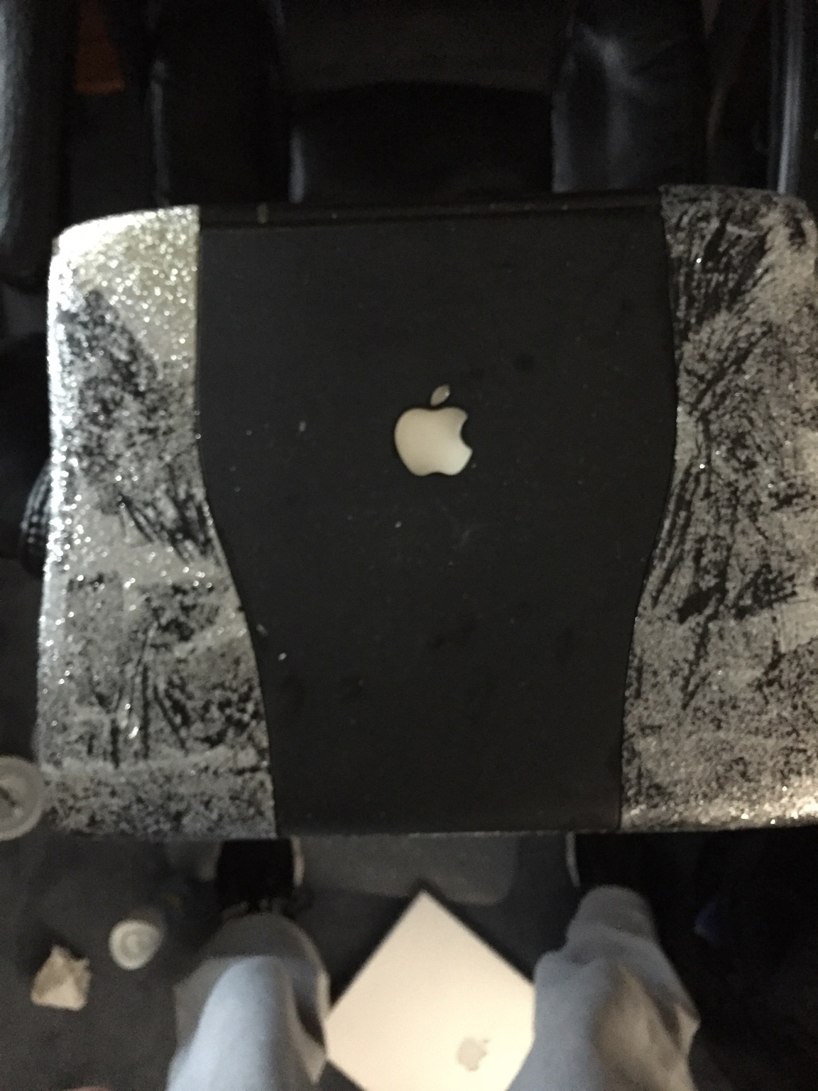

So I acquired two more laptops (bringing my total to 30 machines, 20 of which are macs!) yesterday from another user on here. I got a PowerBook G3 Pismo and a pre-unibody first gen MacBook Pro with a Core 2 Duo processor. As I usually do with all my machines, I clean them out. However, this is particularly going to be a challenging restoration project. The G3 on the two side panels has giant stickers of glitter that cover up the entire panels. I removed the stickers, but it's left behind extremely sticky glitter all over it
So far I have tried to use Clorox wipes, (this is what I usually use for everything) which did nothing, a screwdriver, which has worked the best so far, and some nail polish remover, which removed a little, but made my room and the entire house stink.

Sticky label remover should help to clear the gunk but check that it doesn't otherwise harm the surface.
Reactions: Gamer9430
Depends if it's hard plastic or soft touch. Solvents and sticker remover have a nasty habit of damaging soft touch. Suspect you'll be putting some elbow grease into this one!
The easiest manual way would be to use gaffer tape to remove old residue but if it has in any way hardened onto the lid you will need to scrape it off very carefully
Acry-sol or paint prep. It's used by body shops to remove oils and residues before painting. I've used it for years and have yet to find a surface it doesn't work on. Still test it first but it works very well on adhesives. You can get it at any place that sells body shop supplies. Some auto parts stores carry it.
