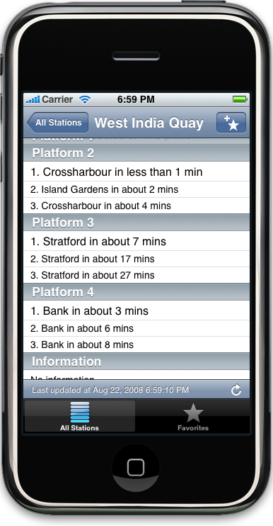

I simply placed the toolbar where I wanted it (in code) and made the table view smaller by the height of the toolbar.

Hey Robbie, could you post your code for that or at least an example that does what is in the picture? I'd really like to see it, thanks.
Well, I intend selling this app to try and hopefully get some of the fee for distributing apps back, but I don't see that this part of the code is in any way special!
The basic structure of the UI is that I have a UITabBarController created in the app delegate when the application starts (in code, I have no xibs or nibs). I then add two UINavigationController objects to it (via the viewControllers property).
When the user selects one of the stations presented in the tables that the navigation controllers display I push a view for that station. It's that final "leaf" view that the screenshot is of. So we have already have the tab and navigation views on screen.
This is the (simplified) code for loadView in that final UIViewControllerSubclass
Code:
- (void) loadView
// Set the size for the table view
CGRect tableViewRect;
tableViewRect.size.width = [[UIScreen mainScreen] applicationFrame].size.width;
tableViewRect.size.height = [[UIScreen mainScreen] applicationFrame].size.height-27;
tableViewRect.origin.x = 0;
tableViewRect.origin.y = 0;
// Create a table viiew
tableView = [[UITableView alloc] initWithFrame:tableViewRect				style:UITableViewStylePlain];
// set the autoresizing mask so that the table will always fill the view
tableView.autoresizingMask = (UIViewAutoresizingFlexibleWidth|UIViewAutoresizingFlexibleHeight);
// set the tableview delegate to this object
tableView.delegate = self;
// Set the table view datasource to the data source
tableView.dataSource = self;
// Set the size and position for the "status" bar.  This is actually a UIToolbar as we have clickable buttons on this
CGRect statusRect;
statusRect.size.width = [[UIScreen mainScreen] applicationFrame].size.width;
statusRect.size.height = 28; // Not this height is hard coded
statusRect.origin.x = 0;
statusRect.origin.y = [[UIScreen mainScreen] applicationFrame].size.height-120; // Note that 120 is hard coded: would be better to find the height to subtract from the existing views
// Create the status bar/toolbar
statusView = [[UIToolbar alloc] initWithFrame:statusRect];
// Status items creation/sizing skipped
statusView.items = idleItems; // Idle items is an array of items to display when download not in progress
// This view contains the table view and the status bar
UIView *totalView = [[UIView alloc] initWithFrame:[[UIScreen mainScreen] applicationFrame]];
[totalView addSubview:tableView];
[totalView addSubview:statusView];
self.view = totalView;
[tableView release]; // Don't leak memory!
So there we go: it's pretty simple and straight forward. As noted it would be better to read the heights from the tab and navigation bars, but this does work 🙂
Hope that helps...
