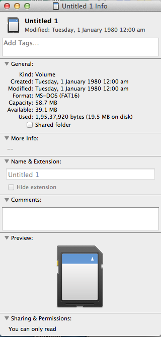

Following is the screen grab of the info from finder

Something that a lot of people don't know is that the read only switch is checked physically, that is, the reader checks if the switch is on or off. It doesn't actually change anything inside the card.
Therefore, the sensor that checks this is probably jammed or shorted or something. You can try to clean it out very carefully when the iMac is off, but there are better routes.
