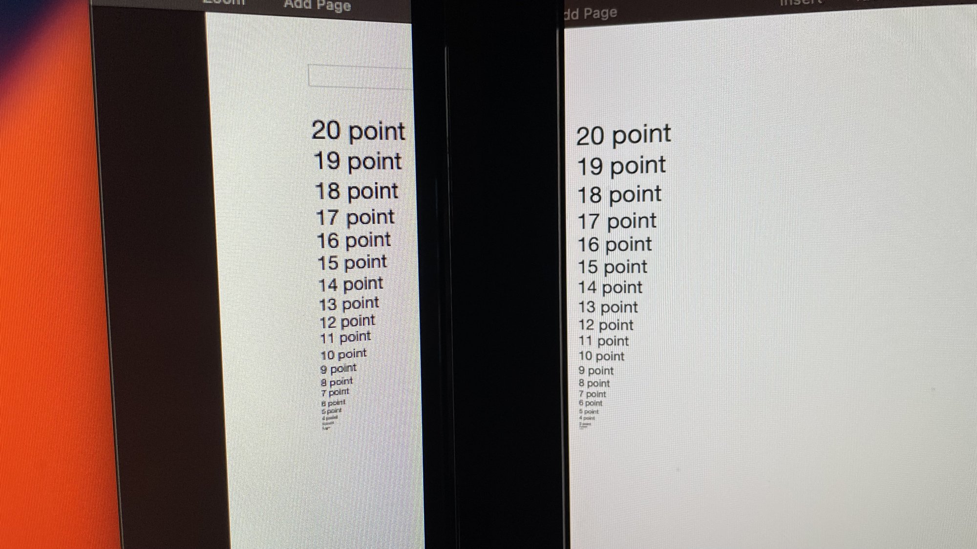

I'm just not seeing it ¯\_(ツ)_/¯ I have an LG 27" 5k display, and an Acer 23.8" 2560x1440 hooked up to my M1 mini with macOS 13.1. Unless you're doing everything at the 10 point level or below, both are quite readable to me. Obviously the 5k looks "Better" - which I'd certainly expect. But both are usable.
I guess technically anything you can read text on is "usable" but the photo you uploaded clearly shows how much worse text looks on that Acer looks compared to the 218ppi of your 5K display.
Yes, that looks usable, but not great either. What resolution are you running on the 23.8" 1440p monitor? Something like 2304x1296?
The difference is more noticeable in the photo than in a live view - the photo of course can be enlarged to make the difference more stark. I’m running native 2560x1440 on the Acer, and I often move things to either display and have no difficulty reading text on either one of them. Obviously it looks “Better” on the 5k, if I concentrate on the characters I can see that it’s smoother on that display. Well, duh, it has 4x the resolution so I guess it’d better be smoother 🤣 but the OP’s assertion that it’s a “World of pain” and “Blurry and pixelated” is hyperbole.
