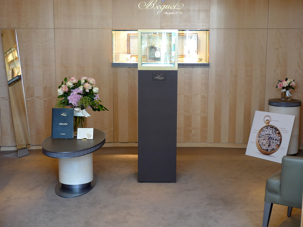

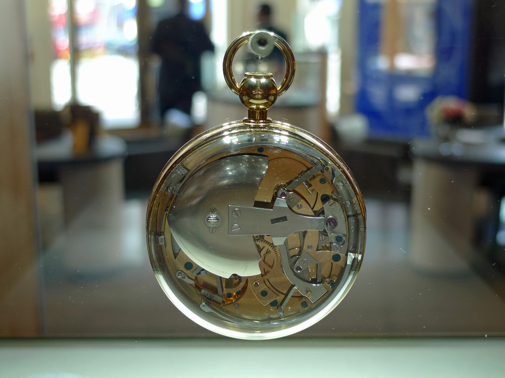

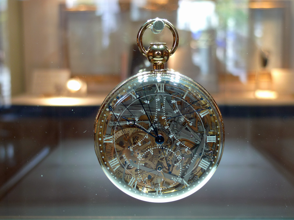

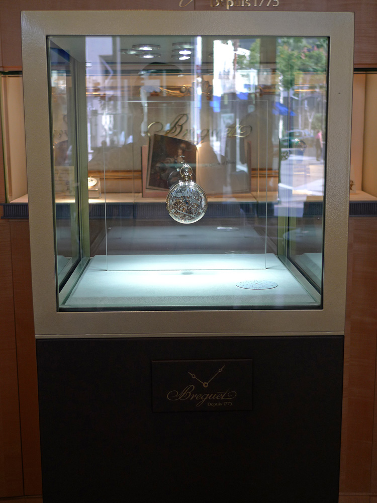

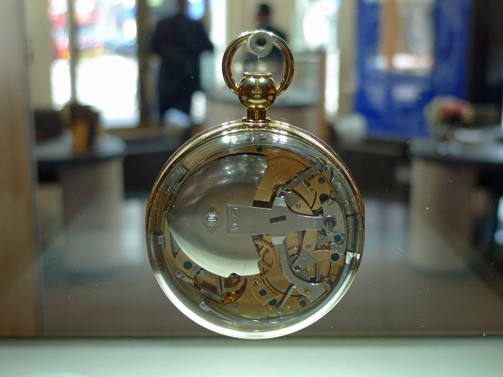

I was fortunate enough to take a few pics of this amazing timepiece this morning. And yes, the pic of the back of the watch is the automatic winding weight and mechanism, invented by Breguet.

What made that particular watch more complicated than other watches of its era?
It looks like it has lots of gears and things inside. Were they more complicated? Advanced? Did it keep better time?
Taken from the Time Zone link above...
• A self-winding watch with a minute-repeater striking the hours, quarters and minutes on demand.
• A full perpetual calendar displays the dates, the day and the months respectively at 2 o'clock, 6 o'clock and 8 o'clock.
• The equation of time at 10 o'clock proclaims the daily difference between solar time and the mean time told by watches.
• In the centre, the jumping hours – invented by Breguet – and the minutes are joined by a long independent seconds hand, while the small seconds are shown at 6 o'clock.
• The 48-hour power-reserve indicator 10:30 balances a bimetallic thermometer at 01:30.
FWIW perpetual calendar means that the user doesn't need to make any corrections for months that have 28, 29, 30 or 31 days. This is programmed by mechanical gearing.
As far far as precision is concerned, while Breguet made many contributions to improve time keeping, that title rightly belongs to an Englishman named John Harrison who invented the marine chronometer and achieved an accuracy of less that 2 seconds deviation while undergoing 30 days of sea trials. Many quartz watches today don't achieve that kind of accuracy, hence the reason that many of them rely on correcting themselves via the atomic clock in Colorado.
