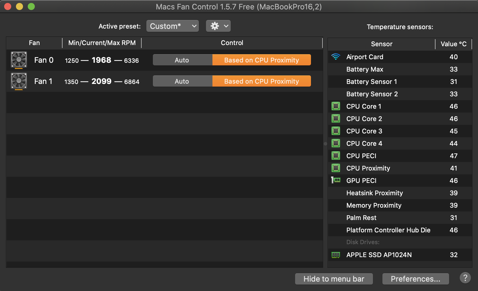

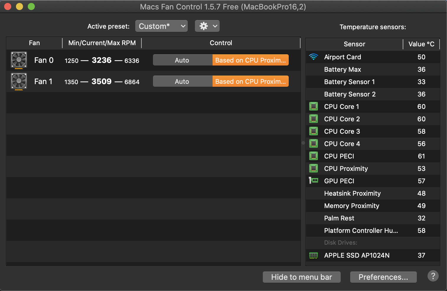

Right now, I am using Brave browser with a few tabs open, having an external monitor connected, an audio interface connected that draws power from the mac, charging over MV hub (where hdmi goes into), ableton live 10 active, discord active and telegram active, with the following stats:
Additionally, here is how the temps look like with the mac having nothing attached to it - all ports free, no charging:

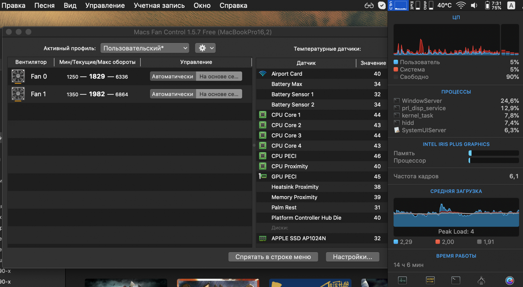

Here are my stats on MBP 13 2020 with your MFC settings and 2 virtual machines running (Linux with docker containers and Windows 10). Fans are almost silent. Palm rests are cool.
Next, I'll try the same case on charger.
