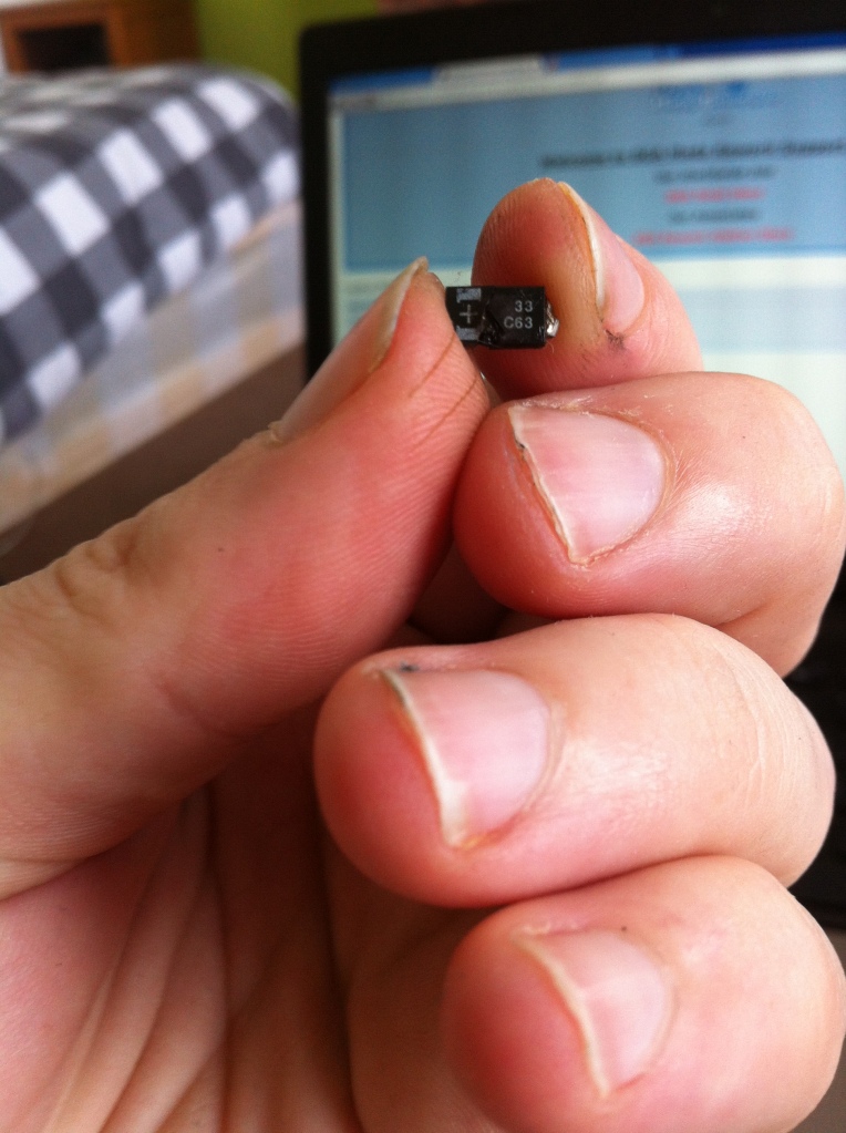

i plug ac in and smoke comes from underneath. Turned it around and this weird looking cap idk what type of cap it is, or even if its a cap.
