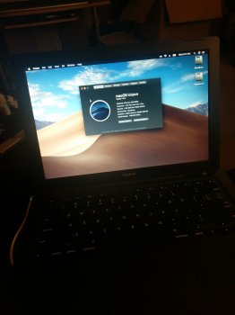

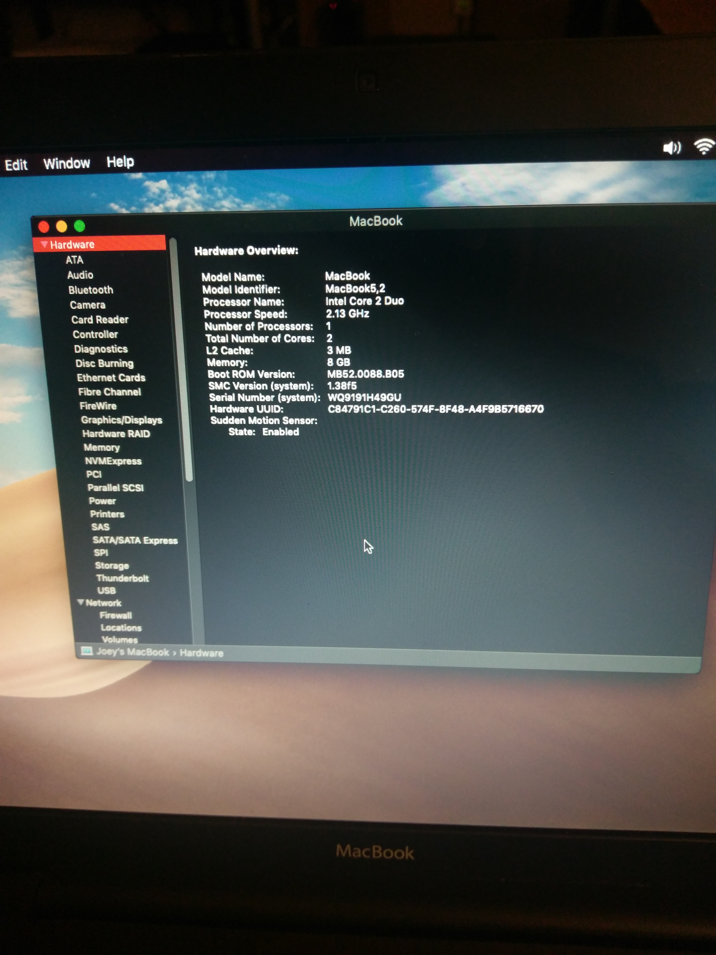

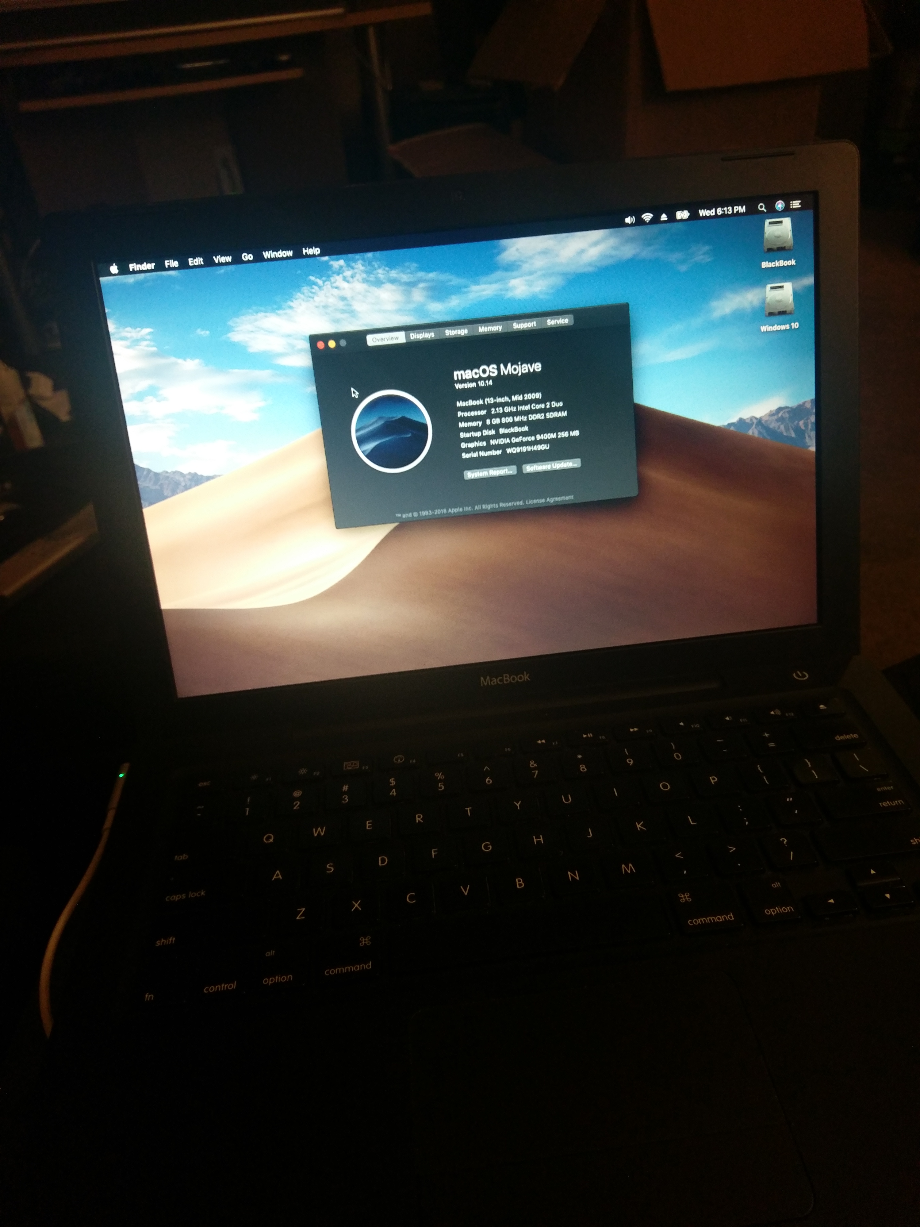

Here's a couple
I have a MacBook5,1 (Al-unibody) with 8GB of DDR3 RAM, but I didn't realize the 5,2 could handle 8GB of DDR2.
Everymac and Mactracker both state the 6GB ceiling as per the 4,1 and earlier. Maybe it was an "undocumented" benefit of moving to the NVidia MCP?
I'll have to bite the bullet and drop $$$ on some 4GB DDR2 DIMMs to test out my 5,1's with 8GB like yours.

the 6GB limit on the MBP/MB3,1/4,1 and iM7,1/8,1 is down to a Memory map issue with the i965PM/965GM chipset/EFI Firmware
you CAN install 8GB of RAM in those systems however they will either fail to boot OS X properly, or while they may boot, if you use more then 6GB of RAM the system falls over
MCP79 macs dont have this bug, and as such, 8GB works fine in those systems (poking around in the firmware of the MB5,2 shows an actual theoretical limit of 32GB, but good luck getting there on DDR2 SODIMMs 😀 )
what people dont realise with the MB5,2, is that motherboard architecture wise the MacBook5,2 is completely different to past Plastic MacBooks, and the MB5,2 shares MUCH more in common with UniBody MacBooks then it does with any Pre unibody otherwise (the MB5,2 is very much a wolf in sheeps clothing)

The 3,1/4,1 bottom case requires a very small modification to fit a 5,2 board, and that is removing one single standoff. Once that's done, a 5,2 board will fit no problem.

As dosdude pointed out; you remove the one standoff. You'll know which standoff it is when you try to line up the board. Then screw a standoff directly to the heatsink on the motherboard in the spot it would be for the 5,2 case.
I used a 2008 4,1 case. I also put the old 4,1 board into the 5,2s original white case. Just cause I didn't know what else to do with those. But the black MacBook is the best looking one they've made in my opinion. Reminds me of the old PBG3s.
