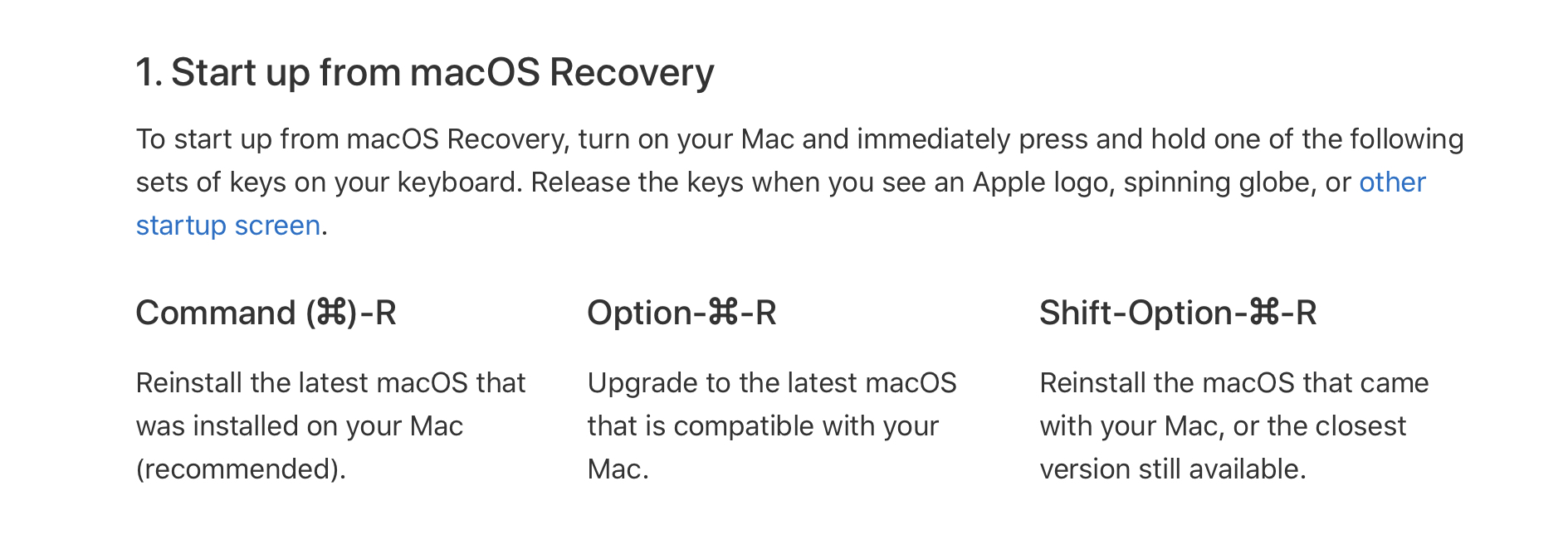

So does regular Recovery. The differences are explained In this article.
cmd+R is regular Recovery
opt+cmd+R and shift+opt+cmd+R are the two Internet Recovery options.
