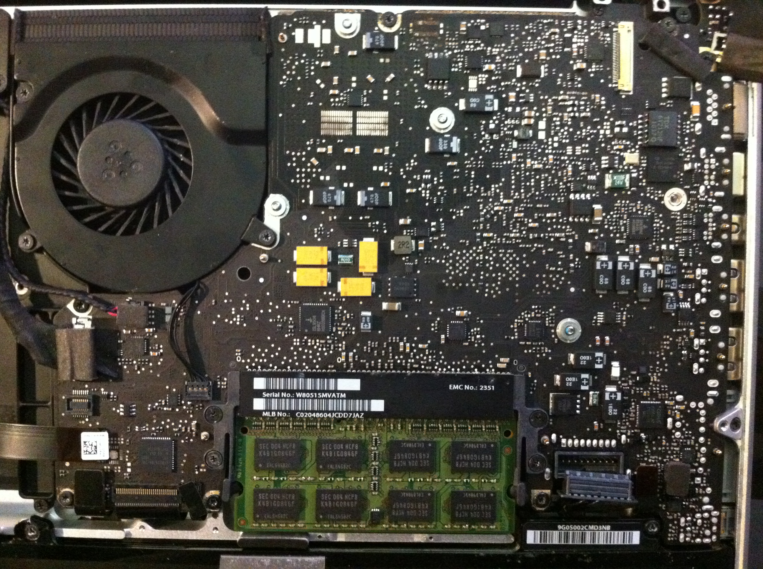

I have a Macbook Pro 13" mid-2010 which has a strange problem. Occasionally, the fan speeds up and the CPU slows down to snails pace. Sometimes this happens during bootup, other times well after. Everything still works, but very slowly. Closing the lid and waiting for the fan to calm down seems to fix the problem, until next time. (Which can be a long time.)
I believe the problem has to do with one of the thermal sensors, but I'm not sure. I've already replaced the drive cable, which has one, but I don't know where the others are.
I would like to fix the problem but can't find any information about the circuit board or the location of these other sensors.

Can someone please post an annotated picture showing where the sensors are, or post a circuit diagram?
Or, if someone's had this happen to them, can you please share how you fixed it.
