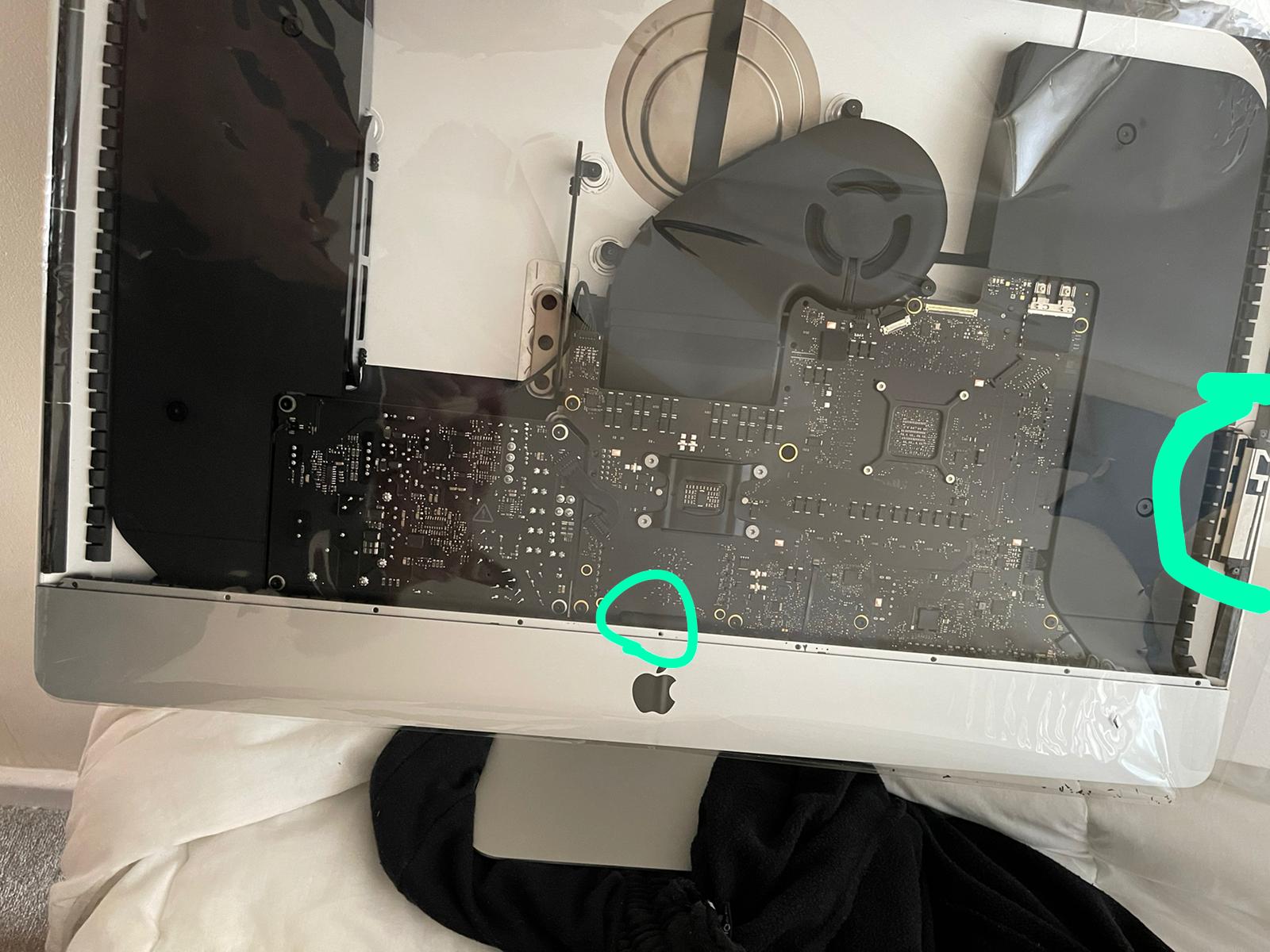

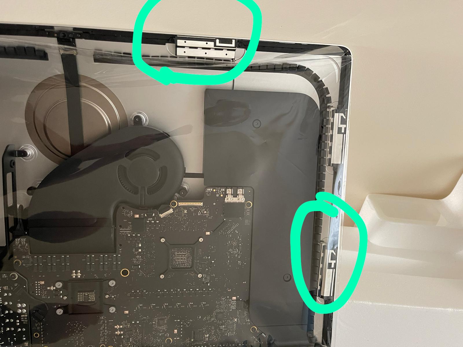

I’ve damaged two other things when removing the screen and am missing a screw for area where the screen attaches at the bottom (near mic) see attached picture with circled items. Any idea what these item parts/screw size is and where I can get them?

Edit: Those circled areas in your picture - the two on the right-side and top are your WiFi/bluetooth antennas. The screw at the bottom isn't too relevant - it's just to support the lower support bracket, which is basically just a thin bit of metal.

Many thanks. Agreed on the screw but just would like to replace it if I can before I put a new screen on the machine.

I am struggling to find the WiFi/Bluetooth antennas. Anyone able to suggest anywhere that posts to the UK? I could alternatively glue thr craxked plastic back I suppose. Either way I’m not sure what screwdriver fitting I need to remove these to replace or repair if anyone can please advise.
