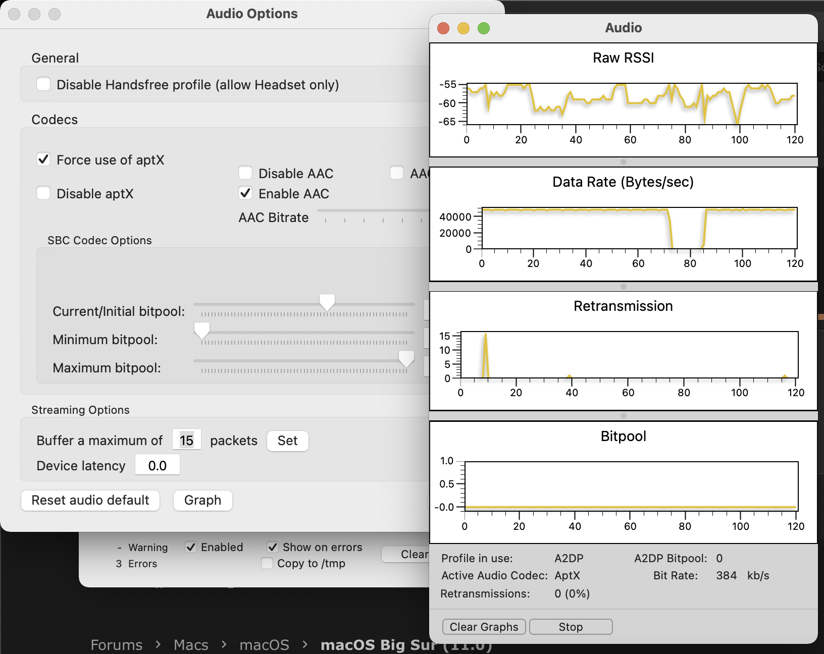

AptX works for me on M1 mini 11.2.2
use older codex tools and graph button to check active codec

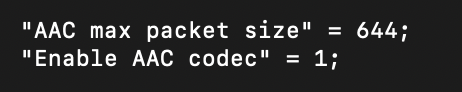

Does this string means the activation was a success?
(this appears after writing the "sudo defaults read bluetoothaudiod" command)
Thank you.
(btw I use the native macOS Apple Music app to play all files, both physical and streamed)
Thank you.
I think so, but the actual choice a given program makes still is a mystery to me, since it also depends on your headphones. I think the only way to really know it to play some audio, and check the Console application for clues as to what codecs are actually being used. It was previously stated/shown in the Option-key Bluetooth icon, but that's absent in Big Sur.
