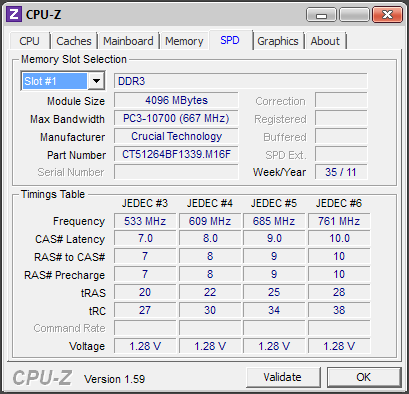

In any case did anybody try reading out voltages in Windows with AIDA64 or just CPUz. I don't want to restart to Windows and a VM is no use for this but part of the SPD settings is the running voltage.
Well, the funny thing is... CPU-Z shows 1.28v, so I'm not sure if it's reporting correct SPD.
Here. Please see attachment.
1.28v is within the range that the low voltage RAM accepts I think.
You could go all the way and put back in the old RAM and read out the voltage again. I would be very interested to see it!

1.28 doesn't sound like it is off by too much.
Most of those low voltage ram have a 1.35V setting for 1600Mhz but 1.25V below.

Put back in old RAM yesterday and CPU-Z showed 1.5v.
But I also found that CPU-Z is only reading SPD directly off the RAM chip, not the actual voltage. AIDA64 or Everest don't really show voltage information at all.
