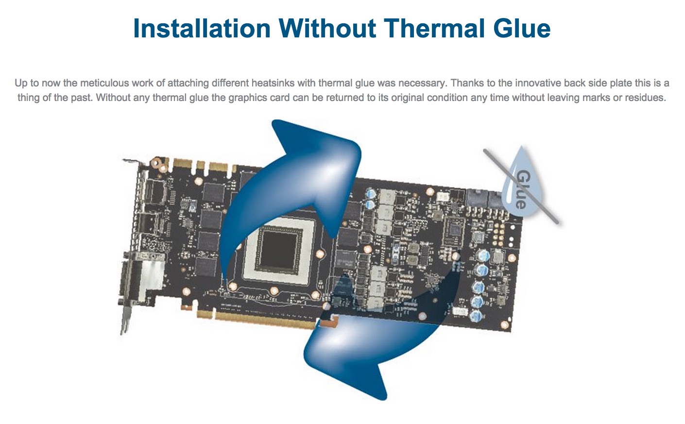

The Accelero Xtreme IV looks very good, however, the back plate make it can't fit in the cMP.
And the Accelero Xtreme III is not available at this moment.
I doubt if it's possible to run it without the back plate.
It seem the back plate is one of the key to hold the heatsink on the GPU.
If I run it in slot 2, it's triple height will block both slot 3 and 4, leave me only slot 1 to use. However, I need 2 more slots to run my Tempo SSD and USB 3.0 card. So, it's not an ideal option as well.
I'm sure it is but you could use small nuts and washers to hold it. Back plates are mostly there to give cards added rigidity that you don't need because cards are mount upside down in Mac Pros. I'll grant you it's a $100 gamble but that's kind of why I'd do it, to make it work when it shouldn't.
Keep in mind that most (if not all) AC coolers are 2,5 slot high. So for those who have all 4 occupied it could be a no-go.
