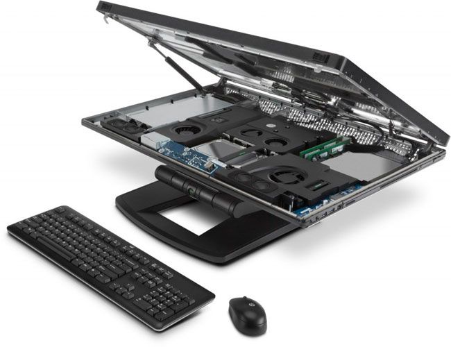

The other issue is unlike PC desktops even many PC all-in-ones, it is difficult to take an iMac apart for cleaning due to Apple's use of adhesive sealing. You run a real risk of breaking the screen or internal components on Retina iMacs.
HP:

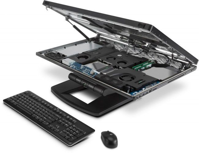

HP:
