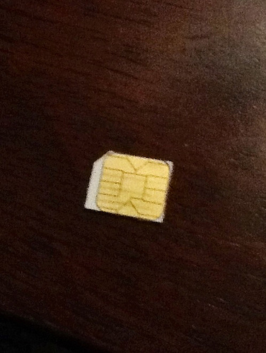

I've successfully cut 2 miniSIMs down to microSIMs that work fine in my iPhone 4s. Now I have another miniSIM (the one that has all my prepaid $$ on it!) that I want to cut down. Problem is, this SIM has a large-size chip. The chip is much larger than it is on either of the other two mini-SIMs--on which I only had to cut away plastic. Here, it is inevitable to cut part of the chip (albeit a part that doesn't make contact). So I'm pretty scared because one wrong snip and I lose nearly $100 in credit. I found a tutorial online that shows how to trim these types: http://www.solutios.com/simcutting/
Problem is, I can align the circuit lines two different ways as follows:
and:
So which is it, align top or align bottom? Thank you!!!

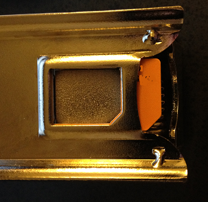

I have a sim cutter from cutyoursim.com and this is what it did to my sim. Looks to me like it took the middle right out.

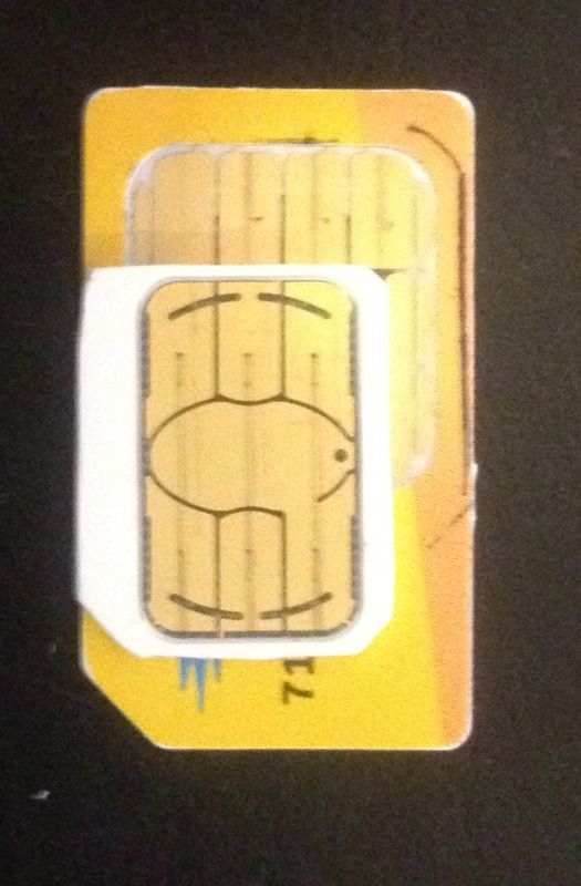

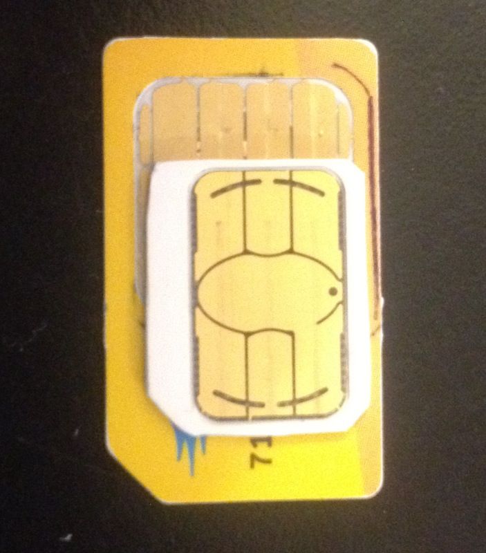

Do not align anything, cut in the same place as shown that the cutter does. If you align it I am afraid you will end up with the contacts shifted off to one side. This might help, this is a real microSIM from ATT for my ipad. Note how the contacts are off to one side, this is the way it should be so they can line up with the metal fingers in the sim slot.
The only thing that concerns me is that you may end up with the metal contacts in contact with the metal sim tray. You want to insulate them somehow, maybe with paint?
Or in other words neither of the pictures you posted in the first post look correct to me, that cut sim looks like it is slightly off to one side. It likely works because the amount it is off is less than the width of the contact.
As I have shown the amount of material you remove should be about the same on each side, as you can see with the leftovers I pictured.
