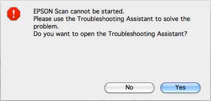

I'm fed up with the new scanner I bought. It works once in a while but usually produces an error messages instead. I can't tell if it's a hardware or software problem. The scanner software has acted up (refusing to initialize) all but 3 times out of dozens of attempts to use it. I can't tell why it worked those 3 times and it hasn't worked for a week despite all of my experiments.
Here are the facts...
Platform: MacBook Pro, Snow Leopard
Scanner: Epson Perfection V300
Error: Almost all of the time (100% of the time lately) I get this when I launch the scanner software supplied with the scanner:
Their Troubleshooting Assistant is of no use.
What I've tried:
  • Full power down and restart.
  • Unplugging the scanner's power and plugging it back in.
  • Booting with the scanner on/off or connected/disconnected. Trying different orders to powering-on and connecting.
  • Trashing preference files.
  • Using a different USB cable.
  • Using a different USB port.
  • Uninstalling and reinstalling the scanner software.
  • Updating the scanner software with the latest versions at epson.com.
  • Trying the scanner on another MBP with Mac OS X 10.5.
  • Contacting Epson customer service (I never heard back).
  • Googling for solutions by people having the same problem.
Any suggestions before I fill it with Mentos and Diet Coke and blast it off into space?

I have a really old Epson Perfection and have always had issues with their software, many times just like the screen shot you posted.
Since upgrading to Snow Leopard I have abandoned the Epson software and now just use Image Capture. It works well for my uses, but you might try it out to make sure it has all the features you need.

Image Capture works, and I never knew I could skip the Epson software and use Image Capture instead! That gets me past the immediate problem. The only loss (other than the time I've spent on it) is that I can't use the fancier features of the software that they advertised, such as their presets.

Yes, I ran the uninstaller and then the installer, several times, and installed the EPSON Scan Utility. Scanning still failed most of the time. However, scanning from Preview works just as scanning from Image Capture, both offering the basic scan settings like scan resolution, and I'll settle for that. I can do other cleanup, adjustments, or special effects in Photoshop.
