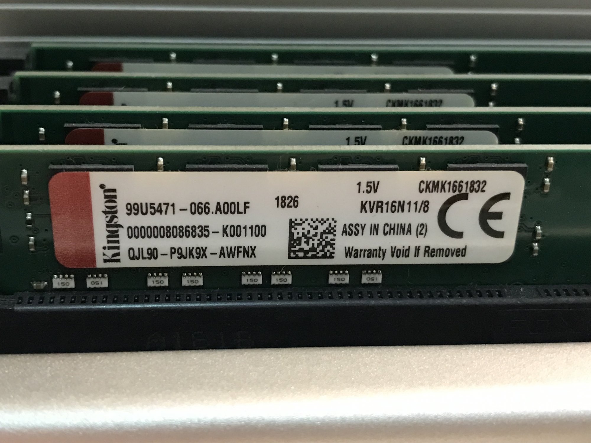

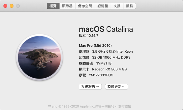

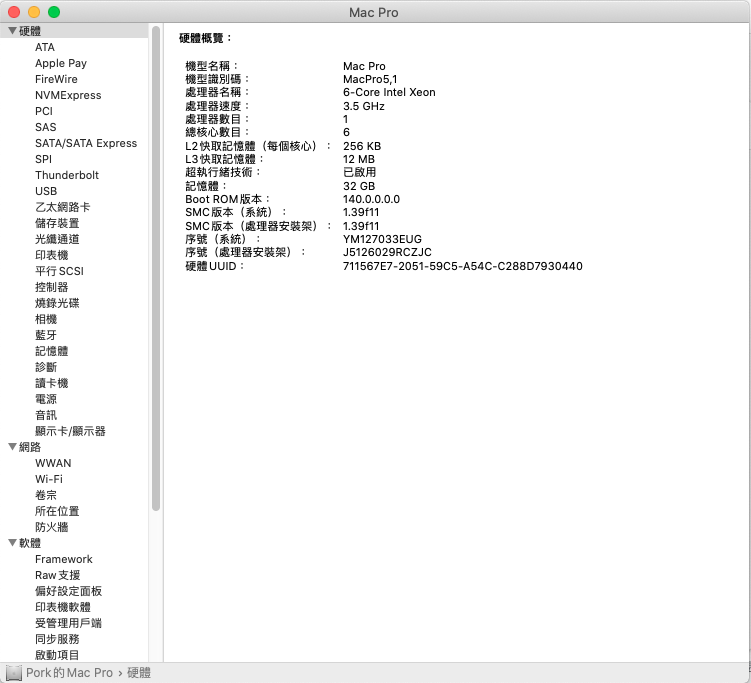

I have a question let me confuse as long time. My current RAM is Kingston 8GB DDR3 1600 1.5v (KVR16N11/8) x 4, my firmware is 140.0.0.0.0, MacPro 5,1 (2010) Single CPU X5690, a few years ago, When upgrading the firmware, NVRAM was also cleared.
Since I have a chance to upgrade to a dual CPU tray these days, I am choosing a suitable RAM. This time I plan to use 16G ECC RAM. However, I remembered this matter. Is there something wrong with my current RAM and MacPro settings? ? Otherwise why does it run at 1066 MHz?
The current system is macOS Catalina, using the opencore solution. However, before I used opencore (macOS 10.12~13), the memory was still running at 1066MHz, so I never understood. What was wrong?

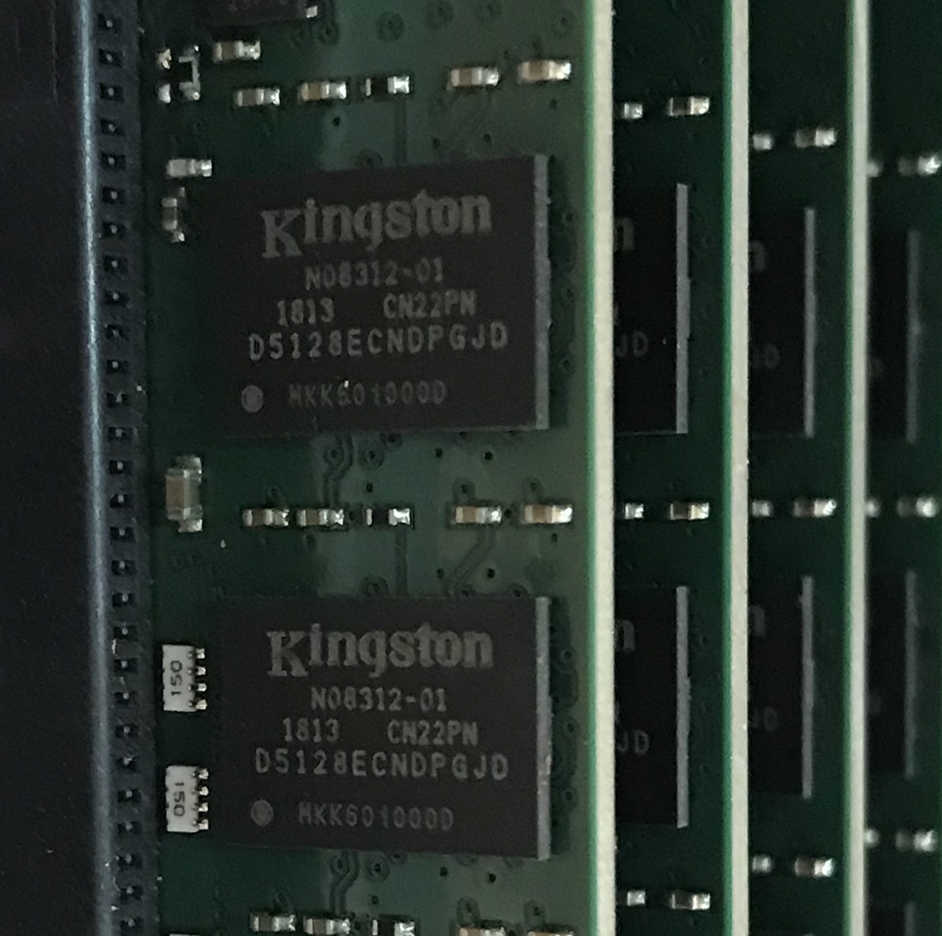

This is a low cost standard desktop RAM, a non-ECC UDIMM with 2Rx8 ranking stated on the data sheet, you need ECC UDIMM or ECC RDIMM with the 2Rx4 rank or the memory controller RAM frequency will be downgraded.
Mac Pro is a workstation/SMBS server platform, not a desktop one, you have to play with different rules than desktop computers and using the a different type of memory than what is required has penalties or don't even work.

Really? I thought the 2010 MacPro was encouraged to use desktop memory, after you told me about 2Rx4, I watched Kingston 8GB DDR3 1600 1.5v (KVR16N11/8), but I couldn’t find any indication of 2Rx? on it. It looks like it is, thank you.
