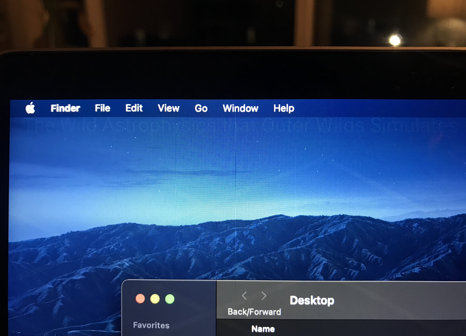

Is there any update on this? My 2018 macbook pro just started doing this: shifting between warm & cool at random. It seemed to have started when I began using Night Shift (something I really regret doing now, since I work a creative remote job and this is really annoying).
Additionally, I had a slight and recent video "burned in" to my display. It's subtle but there (see attached). I'm upgraded to Big Sur and don't have the option of unchecking True Tone. I've also messed around with Night Shift and it persists.
Any updates to this problem that someone could share to help me out?
