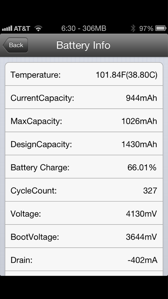

ImageUploadedByTapatalk 21374532501.292933.jpg. Only tweaks I have enabled are BiteSMS and lock info...nothing pirated.
Would it be advisable to get a replacement? The only problem is that I will lose the jailbreak..
Help!

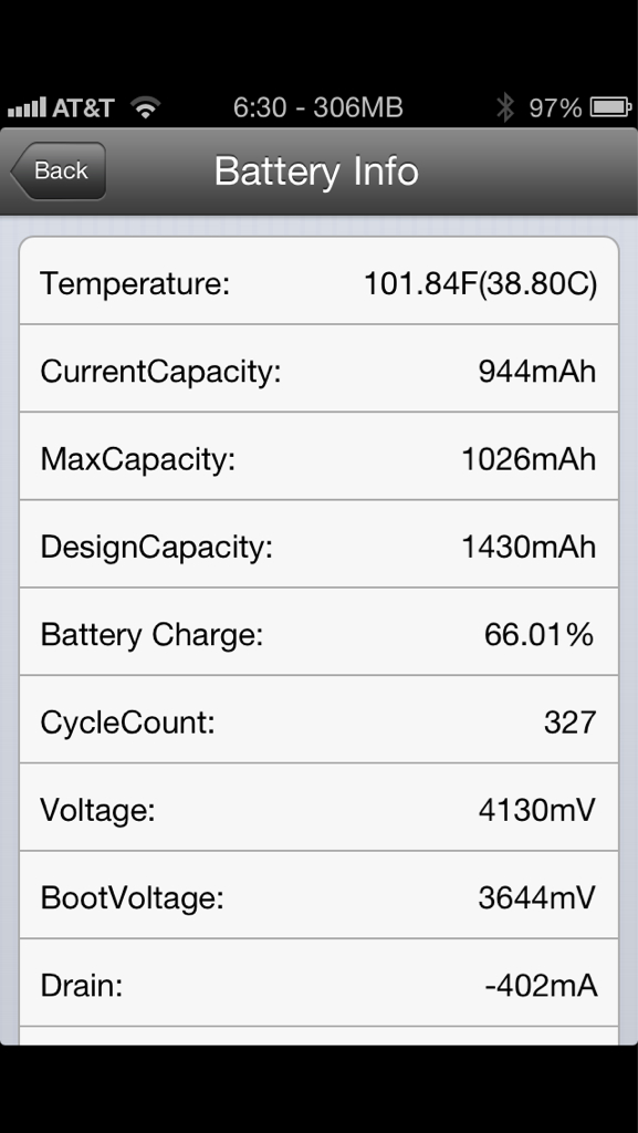

View attachment 424267. Only tweaks I have enabled are BiteSMS and lock info...nothing pirated.
Help!
How long have you been looking at that app? It takes a while for things to settle down after opening it. Turn off auto lock and watch it awhile.
Also install mobile terminal and top. Run top. See what processes are running wild.
Only if you can confirm that it's a hardware issue. Standard troubleshooting applies.
