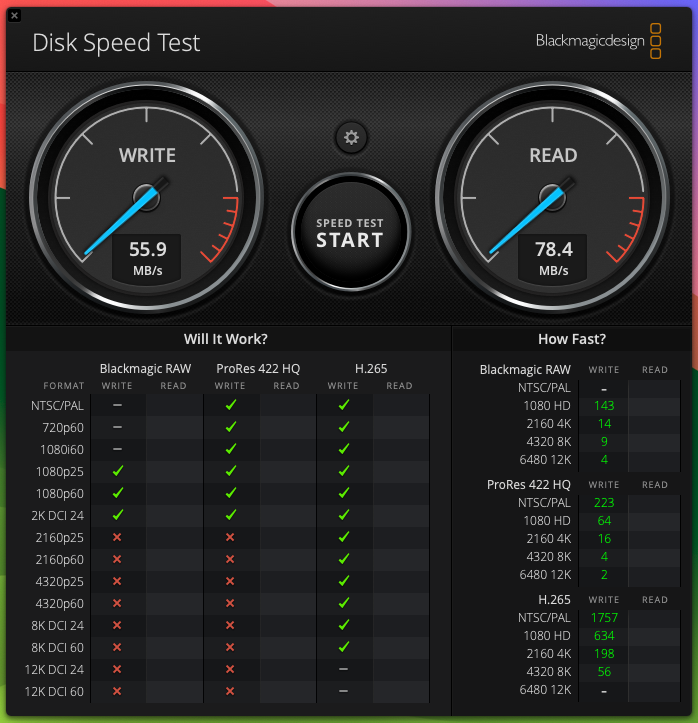

I've connected USB2 and USB3 external hard drives to my Mac Mini M2, by themselves, with no other USB device connected to any of the remaining ports, and the speed is just atrocious. Screenshots attached.
This is an external USB2 WD hard drive:
This is an external USB3 WD hard drive:

The speed of the USB-2 drive is in line with USB-2 top speeds (especially if its a spinning drive).
When you go into System Report does it show USB-3 drive connecting at the full 5 Gbps? Or at reduced 480 Mbps?
The speed of the USB2 drive is not the problem. I put it to hammer the point that the USB3 drive is operating at nearly USB2 speeds.
Yes, the negotiated speed reported by System Info is "Up to 5 Gb/s".

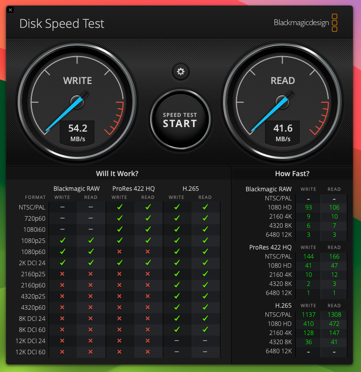

I disconnected the network cable and ran the test, getting even slower speeds (36.0 MB/s write and 40.1 MB/s read). I had to stop the test midway to check I had selected the USB3 drive (it was) and ran it twice more while checking every time it didn't switch targets to the USB2 drive by itself (it didn't) to verify it wasn't an error. I made sure to try again with wifi completely disabled (not just disconnected) and the results remained the same.
I then ran test with the network cable connected and the transfer speed improved.
I disconnected the cable once again and repeated the tests and the transfer speed remained unchanged from the immediately previous test.
I have no idea why doing this changed things, or why there was even a change in the first place, to be honest, and I'm more than a bit annoyed at the inconsistency of it all.

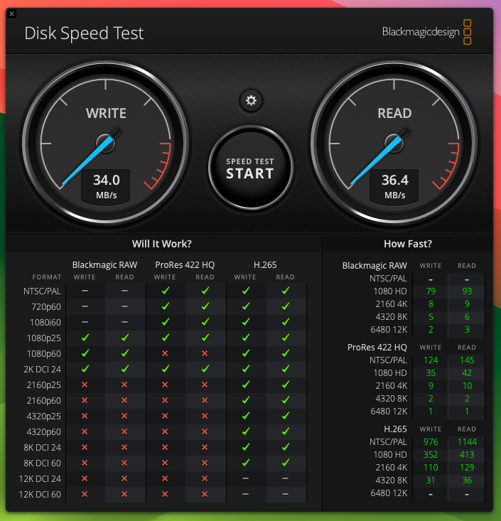

They're formatted as encrypted APFS. I know about enumeration being an issue on rotational hard drives, but the problem I have concerns write and read speed, and what Blackmagic measures is plain read/write speed to media.
I have iStat Menus and waited to start the tests when I saw the R and W activity lights for the device were off to avoid interference.
I haven't disabled Spotlight on the drive because I rely on it to sift thru stuff.

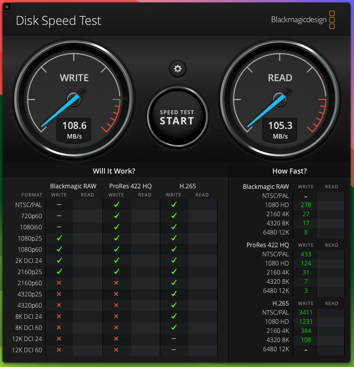

I had an old machine that stopped working and found myself with a free hard drive. I put it in a generic StarTech USB3 enclosure I had lying around, connected it to the Mac Mini and ran some tests to see if there was any performance difference with different disk formats.
Finding #1: It's how fast the brand name WD USB3 drive should have been. It's baffling to me why it performed on a Windows PC and underperformed on Mac.
Finding #2: Encrypted APFS is indeed slower writing, but read performance is on par with the others.
StarTech enclosure (ExFAT):
StarTech enclosure (HFS+) (couldn't test the encrypted format because it's not available anymore):
StarTech enclosure (Encrypted APFS):
PS: I also tested the WD drive with the StarTech cable and the result was a hair higher, but about the same as last time, still far from the StarTech performance:
