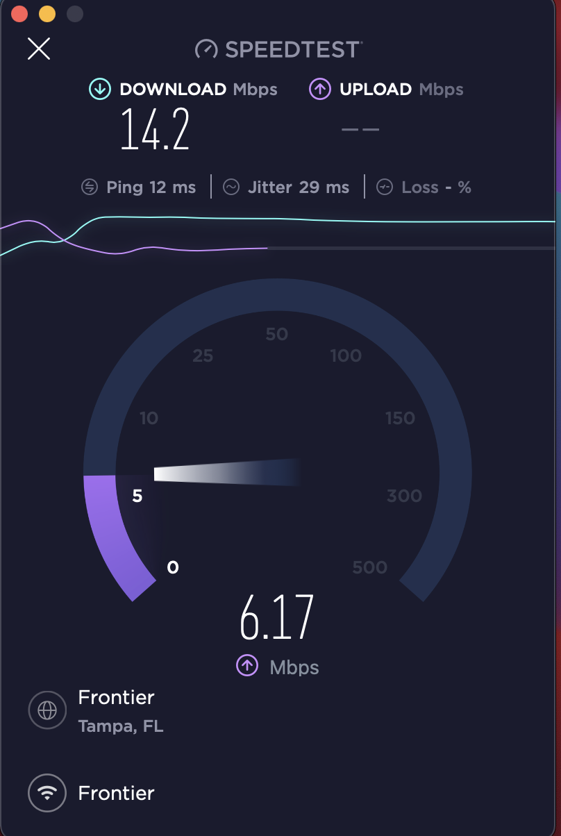

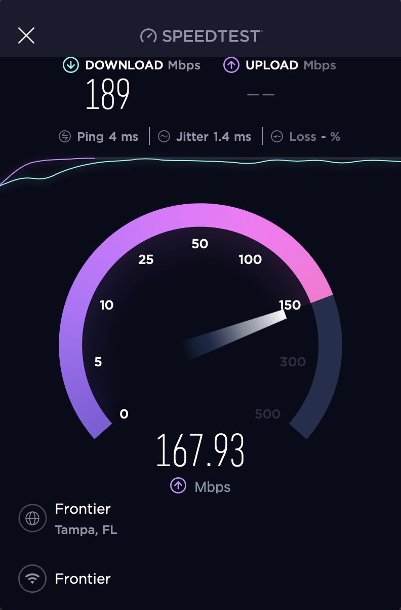

Secondly, when it does work, I have horrendous speeds. I ran Speedtest and took screen shots of both my MacBook Pro and my iMac, sitting on the same desk. Its like my MacBook Pro has reverted back to using a 56k modem.
Everything is up to date, and I know it is not an issue with my WiFi access point (I use Ubiquiti which is amazing).
Any ideas on what I can do? First two attachments are the MacBook Pro, second are from my iMac (download followed by upload).

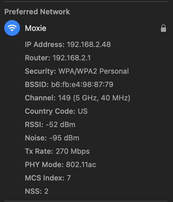

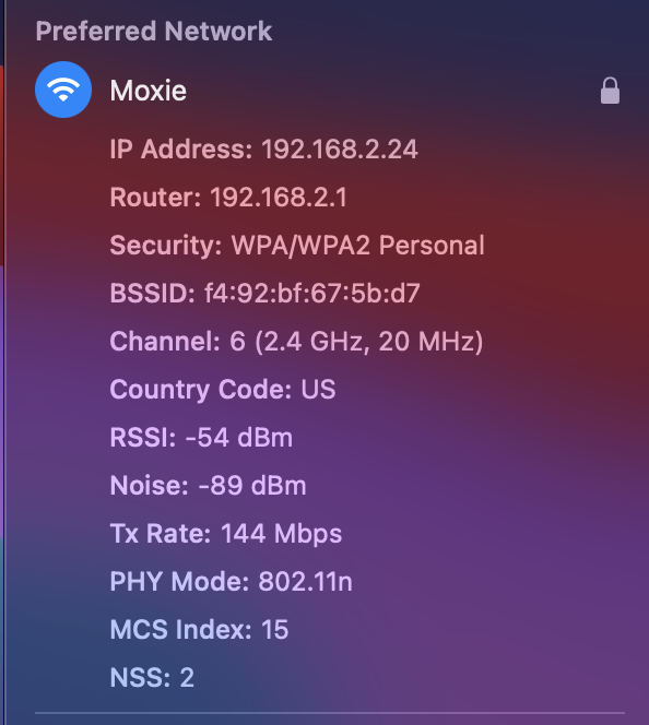

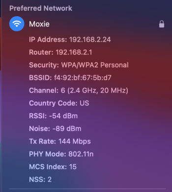

Now that you asked, I did look at the WiFi connection, and my iMac is connected at 5 GHz and my MacBook Pro is connected at 2.4 GHz...
Should I delete my network connection on the MacBook Pro and rejoin?

I'm not really sure what you are asking here. Both computers have 802.11ac capability.
Indeed I noticed that too. Looking at your screenshot, assuming the MBP is for the right picture, it's running the aged 802.11n standard. It should be as the iMac also on 802.11ac

since your using ubiquiti, I would say create a new wireless SSID for testing and only have 5ghz enabled on the test SSID. Do Speedtest and see if that helps. My guess you have major interference on your 2.4ghz hence the low speed. Keep in mind device will try to connect to the strongest connection, meaning your 2.4ghz is prob stronger since it has greater distance.
Now using the test SSID if speed is good on 5ghz, we can determine that it’s an issue with the 2.4ghz. I would next do a network scan, netspot is a great freeware tool to scan the used channels. Read up on overlapping channels, highly recommend using 1,6 or 11 for 2.4ghz as there is no overlap.
determine which one is the best channel and enable 2.4ghz/disable 5ghz on your test ssid and do some Speedtest. If you find a good channel you want to use, switch over your production ssid to that channel and disable the test SSID.

I ended up restarting my switch and both WiFi access points, and that did the trick to get the MacBook Pro back on the 5 Ghz network. I do still need my 2.4 GHz network, because like you, I have a few IoT devices that are only using that spectrum. I'd prefer to just disable it, but that won't be the case for the time being.
