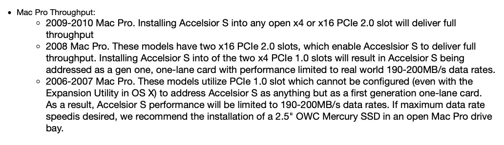

Yes - from cMP 1,1 to 5,1
https://eshop.macsales.com/item/OWC/SSDACL6G.S/
(click on the Compatibility tab)
Reactions: flygbuss
