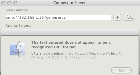

Hi I'm using 10.5.2 and when I try Finder - Go - Connect to server I get the following error.
The PC volumes on my windows network show up on my mac desktop, but connection fails when I try to connect. None of them has a firewall active and all of them can be accessed from each other.
I'd be really grateful for a fix!!!
