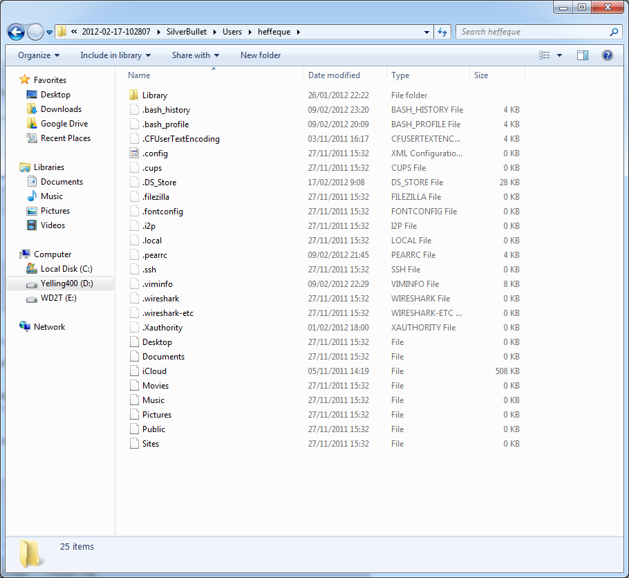

I have Boot Camp 4's HFS+ read access, but the system doesn't seem to understand mac links and folders very well (See "FolderExample.png")

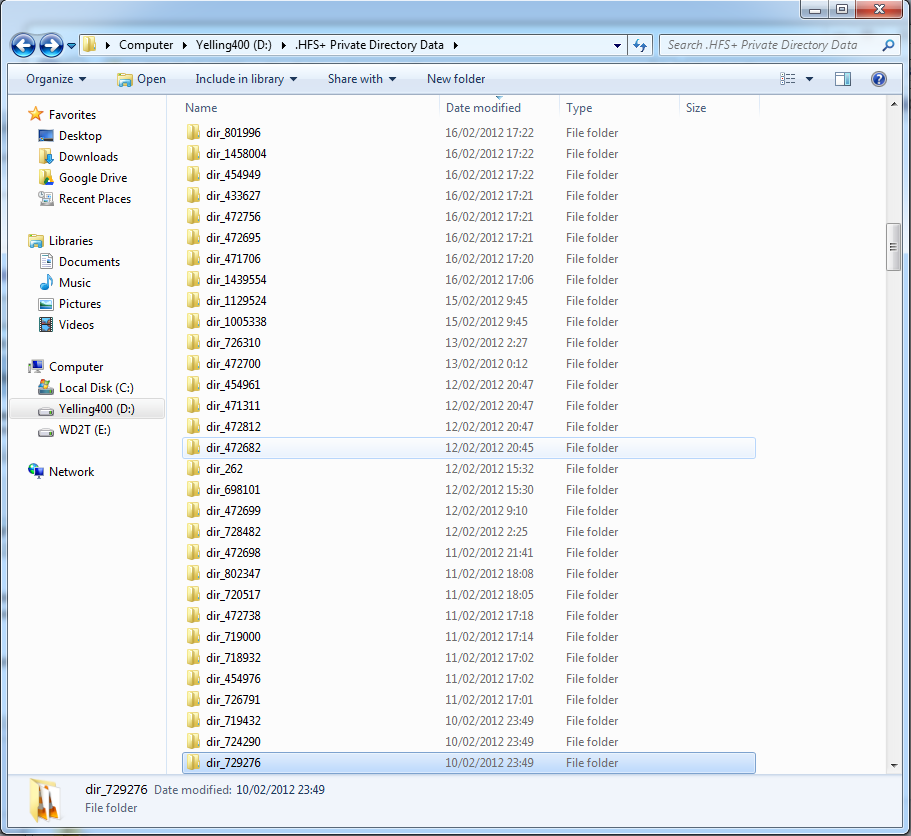

So what I did was try to find the files manually and they seem to be all here (See "HowEverythingIsOrganized.png")
The problem is that when I want to copy a folder... it doesn't. It only copies files, so I have to create the folders individually and copy-paste them manually.
That's more or less ok for folders with lots of files inside and no nested folders but... imagine copying the iTunes folder. It's ****ing hell!

In a word - No.
Time Machine uses Unix type symbolic and hard links, which Windows isn't going to understand even with an HFS+ file system driver installed.
You might have a better chance with Linux.
