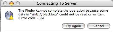

Ok, smb://alayna is the windows computer name I assume? When I type that in (with my windows' comp name instead), I get this:

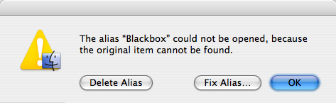

On the bright side, I can browse in the Finder to where the windows computer is (blackbox), but when I click connect:
In Directory Access, under SMB/CIFS, my workgroup name is WORKGROUP, and blackbox is the same.

That means your Windows computer isn't sharing. 🙂
You need to go into Control Panel, go to Network and Internet Connections, click on Set up or change your home or small office network, and when it gets to Sharing, allow Sharing. You will also need to change the workgroup name, as Windows XP likes to assign a different workgroup name (MSHOME). Change MSHOME to workgroup and then your fine. You might also need to restart, lower firewall stuff, yada yada yada. And then try. 🙂
Done, and done. Both computers restarted, but still no dice. Is there something else I could be overlooking?
