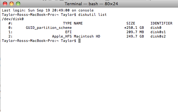

Alright tried the cloning method. Not sure if the problem is solved. Still can't boot into local recovery mode. Internet recovery only gives me the option to reinstall High Sierra, despite the HS partition no longer existing. If there was a problem with the SL partition, wouldn't cloning it just clone the problem too? I guess a better question is - what exactly did I delete when I deleted that hidden partition? Perhaps the only way is to reinstall SL fresh... but Apple says they can't send me a new installation DVD (I guess they don't do that anymore?) and they suggested I reinstall SL via Internet Recovery, but like I said Internet Recovery only gives me High Sierra as a reinstall option.
Good news is I actually am able to use the app based installers (e.g. 10.10 and later), despite what I said in my first post. Before I did the cloning thing and wiped my internal drive I made a partition and installed Sierra to see what happened. So its good to know I could do that again if I need to abandon this SL ship.
diskutil list, after wipe and recloning:

My guess is that you don't have a recovery partition on the internal drive.
There is a small free AppleScript/app out there that may help CREATE a fresh recovery partition.
It's named (of course) "Recovery Partition Creator".
You can find it here:
You want version 4.0.4 (for Snow Leopard)
I make NO promises that this will solve the problem.
But... it may be worth a try.
If things go wrong, just
- boot once more from the cloned backup
- erase the internal drive
- re-clone the external backup BACK TO the internal drive.
I recall using this once myself to create a recovery partition, and it worked.
I'd say it's worth a try.
