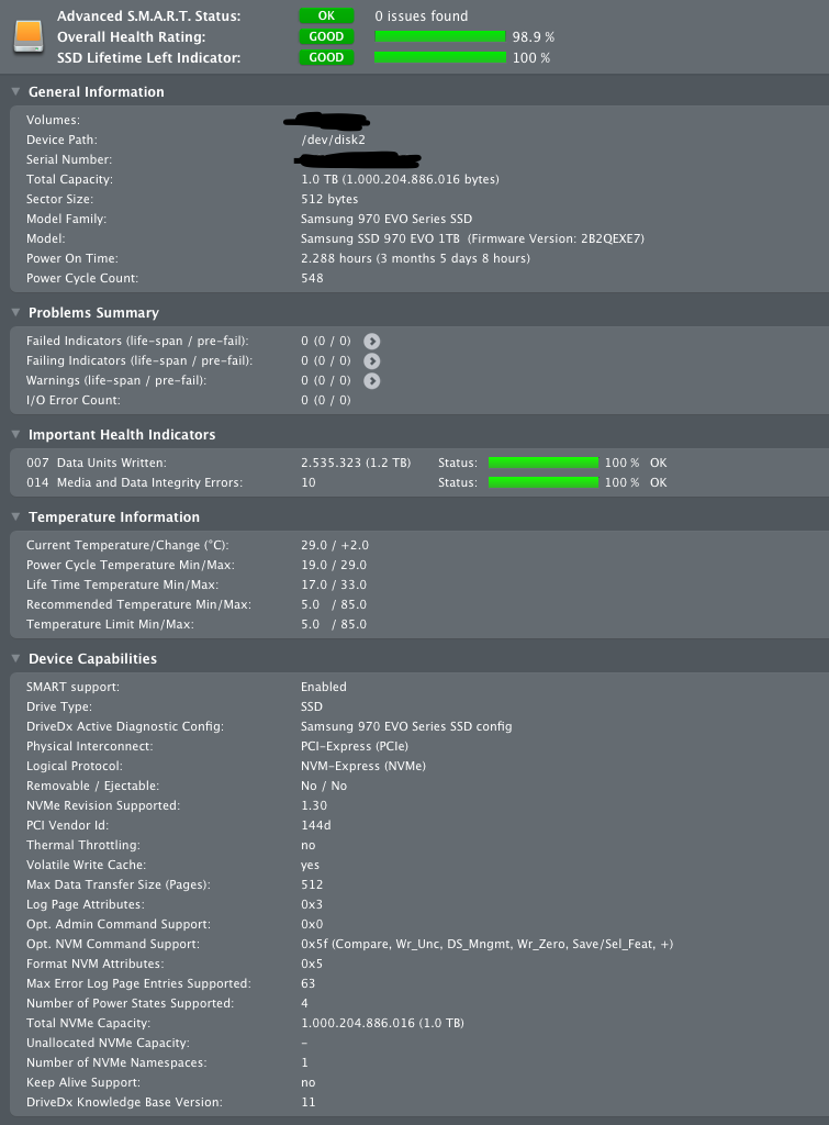

The drive is connected via an Aquacomputer kryoM.2 PCIe card.
Hoping the drive experts here on MR can tell me more 😀
These are most likely to be transient issues, there are no major flags that would indicate impending drive failure here. DriveDX does give a comprehensive report that the vast majority of users would NEVER see. Ensure you have backups (as always). You should be fine.

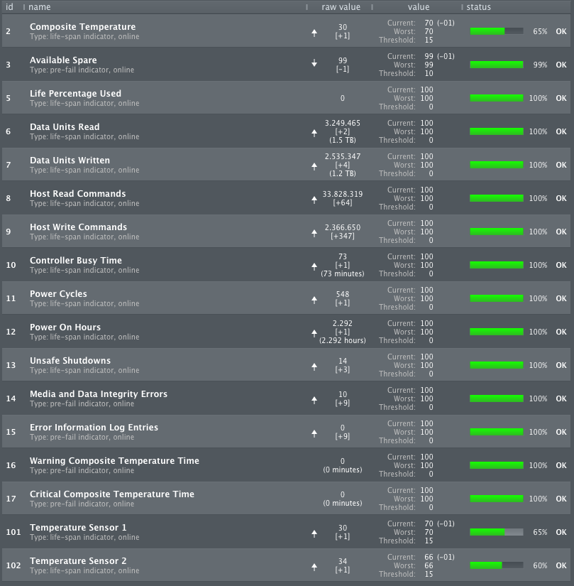

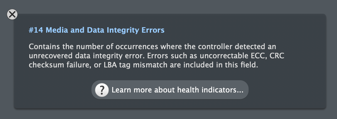

If you click HEALTH INDICATORS in the pane in the upper left, there is a slightly more detailed report for specific health indicators available.

Thanks, bsbeamer, this is what that report is saying about my disk:

I'd keep an eye on it and make sure to have copy/clone of your data on this drive elsewhere. If it went from 1 > 10 (an actual +9) since last reboot, it would signal something potentially wrong with the blade itself and/or adapter.
Try to change adapter first if you had spare. Otherwise prepare a new another 1 TB blade, or at least had clone of current SSD itself.

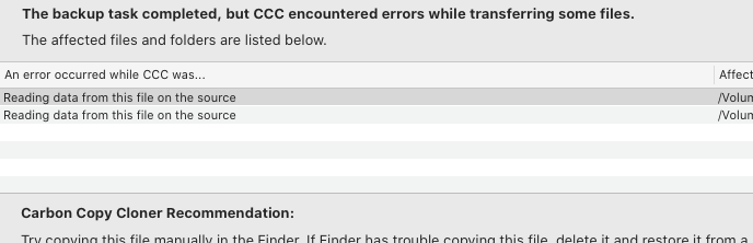

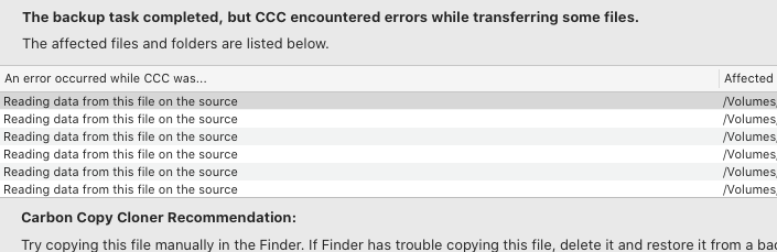

I've been trying to copy the contents of my four 1TB 970 EVOs and one 2TB 970 EVO Plus to a standard (spinning) hard drive and most of the files (like 99%) have copied just fine, but Carbon Copy Cloner has been unable to copy certain files from two of the 1TB drives:
Copying some (but not all) of these files in the Finder also doesn't work (error code 100083).
The strange thing is that some of the files actually WERE copied, but are registered by CCC as "An error occured while CCC was... Reading data from this file on the source".

There is obviously some form of data corruption here. Would not rule out bad adapters, improper blade install, or failing NVMe.
Since it appears to be happening with two separate, are they separate PCIe slots? Two different adapters?
Approximately how much free space on each blade?
NVMe blades formatted APFS or HFS+?
Is the CCC clone from NVMe to spinning HDD with SINGLE PARTITION or does the HDD have MULTIPLE PARTITIONS?

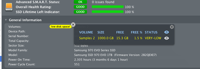

For some reason, the DriveDX Free Space Monitoring was disabled on ALL my drives, and it turns out that the drives with Media and Data Integrity Errors are also the ones with the low disk space icon:
I've started freeing up space.
So, is it safe to say these errors started popping up because of the low disk space?
And has there been any permanent damage to my drives? A couple of corrupted files I can live with, but have my drives been fried?
