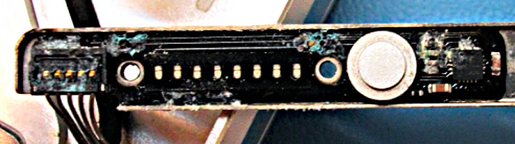

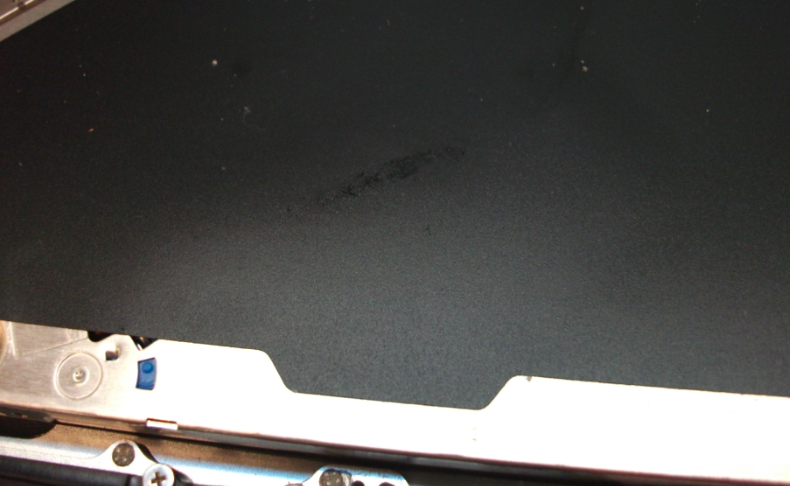

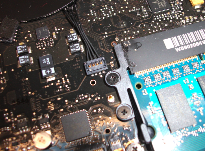

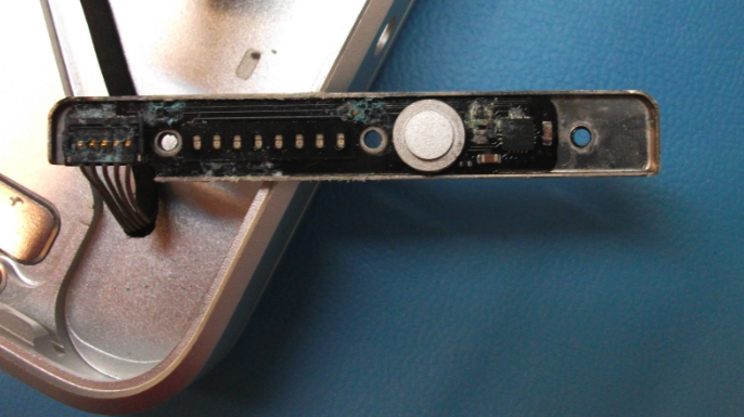

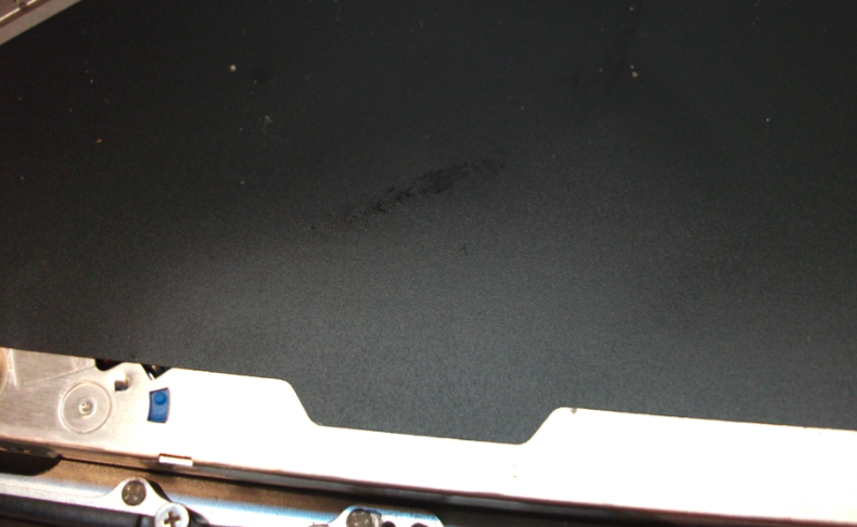

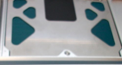

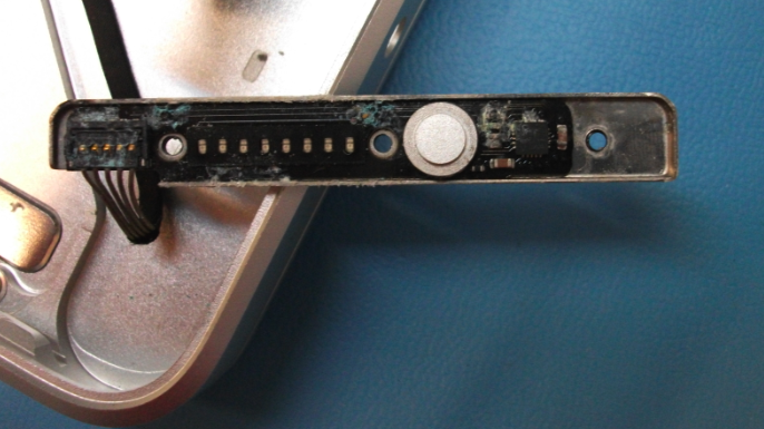

My 2008 mac book all of sudden started making these weird noises. So i took my laptop in to the apple store. The figured it was the fan, ordered the parts and decided to fix it. I get a phone call two days later that i have liquid damage and warranty is void.
I know for fact my computer never came in contact with any liquid what so ever. I called apple corporate office, talked with customer relations, even wrote an email to steve jobs. Apple refuse to even accept the idea that there product could be faulty. First they told me the repair will cost 779 then knocked it down to 449.
here are the pictures... can anyone help me and tell me what they think... they said there is corrosion inside, but wouldnt corrosion be only caused by constant moisture within the laptop? can corrosion happen within 4 months?
thank & cheers

Unfortunately coming here won't help you. Seems you've gone through all the Apple contacts to file a complaint and still were declined to get your computer fixed. If Apple says there is liquid damage, you would have to prove that there isn't and that they are wrong. Try to call again one last time. Do you know exactly what is wrong? Perhaps it's a minor problem that you can fix for a cheaper price.
This sounds rough. If you are certain that nobody including a coworker, roommate, cat, kid, dude on the bus, or cloud from the sky, got liquid on your computer then it is a very sad situation.
The apple store must feel quite certain that there is evidence of damage from liquid. In my experience, there are usually telltale signs of this like discoloration, for example, the aluminum underneath the small pcb in you upper left pic looks very clean, and if liquid had indeed been there, I would expect to see some discoloration.
If apple is firm about their technical opinion, there really isn't any point in getting upset or arguing, they do have some policies they need to stick to.
If you do indeed observe liquid flowing into your macbook the best thing to do is to immediately unplug it and take the battery out. Not so easily done with a non-removable battery. If you take quick action you can usually prevent any damage if you can open up the electronics, gently dab off any liquid with a dry cloth, and then rinse any residue which may be sugary with a cloth dipped in distilled water. Let air dry for 48 hours and reassemble and you should be good to go.
Now to your corrosion. These things are difficult to discern from the pics but from my experience and what appears in the upper left pic, there is some shorting occurring between wires on the printed circuit board. This can be an easy problem to fix yourself with the tip of a knife gently scraping off the powdery, bubbly stuff on the surface of the pcb in between the wires (this white powdery bubbly stuff conducts electricity and causes shorts to occur). Scrape in the direction of the wires, you don't want to accidentally cut across one and have a broken connection. Do this wherever you see any of this powdery, bubbly stuff on a pcb and then use an air canister to get the dust out. Before attempting this, the apple store employee who looked at your computer may be kind enough to to point out exactly where it looks like the liquid damage is inside the computer. It is time on their part so they might not want to spend the time, and the only professional solution they really can offer is to replace any board that appears damaged.
And if it is still dead, the price to fix seems pretty reasonable to me even though it is a bitter pill to swallow since you don't feel responsible for any damage.

Your terminology is wrong. The sensors inside and the visible corrosion are not from *liquid* damage. They are from *moisture* damage. Remember from your school boy chemistry classes that water can be a solid, liquid, or a gas, and that it can change states rather quickly.
The moisture sensors inside Apple notebooks WILL be tripped by very humid air. Use your notebook outdoors on a humid day? Or leave it on the counter in the bathroom while you take a shower? Humidity in the air will condense inside the notebook and trip the sensors, instantly voiding your warranty.

The first photo you posted (of the small circuit board) definitely shows corrosion from liquid. There is also some sticky residue on the main logic board near the RAM slots, but based on your description, it doesn't sound like the logic board is malfunctioning.
You may elect to do a partial repair—ask the Genius to replace the fan and the
small board that shows corrosion, but not to replace the main logic board.
If they insist that $755 is the only way to repair your machine, ask the Genius to familiarize him- or herself with Apple's policy on "partial repairs."

Um. I really don't know what you're smoking here, but that first picture IS water damaged. Normal hardware don't corrode unless it comes in contact with moisture. That includes using it in humid locations or in the bathroom btw.
Furthermore, this is not a heatsink leak. The liquid inside is a phase changing liquid. It is actually very thick and cannot "leak" per say.
Sorry to say but you may not have spilled anything but you'd probably came in contact with something in the environment.

Have looked at thousands of water damaged returns in my lifetime as well as developed liquid indicators for devices as well as partially studied this phenomenon. In summary, the evidence per the first picture confirms liquid intrusion, and large amount of. This is not humidity - while humidity can cause localized corrosion this is not what the picture shows. The picture shows evidence that material was sufficiently pooled.
As stated in a previous post, it is not uncommon that when this occurs that in many cases there was no recollection of an event where this could happen. Things like a family cat, an unknown friend or family member, or other random event like a stranger accidentally and covertly spilling coffee behind you exactly in the right opening in your carry case.
Anyways, the green residue is presumably copper and Nickel Chlorides which are a result of electrochemical reaction. Voltage + electrolyte + metals = electrochemical reaction which when dried up leaves the residue. Along with this residue, underneath it is dendrites or the remains of metallic plating transfer. These conductive lead or tin dendrites cause localized shorting between components.
In most cases, these dendrites can be removed and cleaned up and the device will then properly work. Suggest if not already done then try this first, using either in sequence alcohol and weak ammonia solution to clean up.
