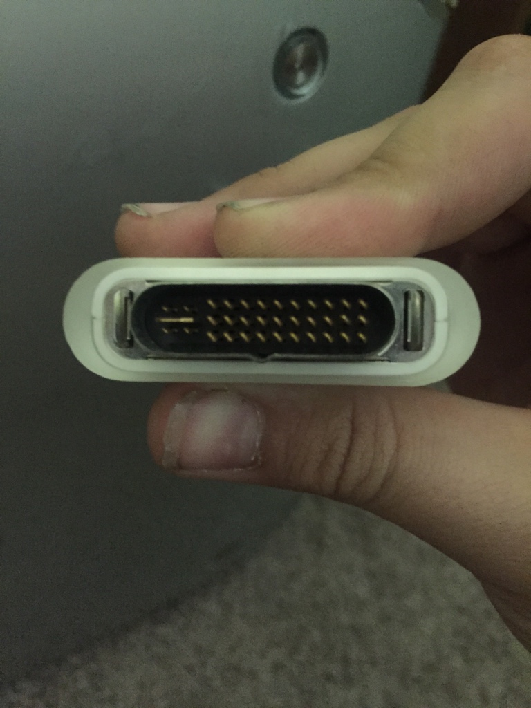

Hello. I bought a mint (like in box, no scratches at ALL) and hooked it up to my QS with a 4MX. The USB ports aren't detected. I've tried PRAM reset, removal and reinsertion, etc. Any ideas?

Interesting. I'd offer to take mine apart to see if its a loose connection or whatnot, but I'd like to preserve it 🙂
Keaton. Shut your Mac down and disconnect the ADC cable.
Take a very, very good look at the pins on the connector. You are looking for bent or misaligned pins. If you find one, straighten it. Then carefully reconnect the cable.
One of the displays I have had this issue when I first got it. Since I don't normally use the USB ports on the displays I didn't notice this was a problem until I tried to use one. The display was working fine otherwise.
It turns out that after inspecting the pins I found one that was bent. I straightened it and carefully reconnected the cable. My USB ports were immediately recognized.

I just last week received two 17" ADC monitors in a package deal with two MDD's.
I'm not actively using them but did check them on arrival. Both of them had non-functioning USB ports, but at the time I was not inclined to delve any deeper into the issue.
After reading your post above I checked the connectors of each monitor and they each had a bent pin, in fact the same pin was bent on both connectors.
I'm not set up to test them at present but I'd wager that there is a very good likely-hood that they'll work.

Yeah, the problem with the bent pin I had on mine was that it was jamming into the same hole as one of the other pins and not in the hole it was supposed to go into. Hence no USB.
It's important when you connect/disconnect the display to make sure you are pressing on the two buttons to the side firmly, then to pull out or push in the connector straight. Don't wiggle, don't let one side go in or out first.
I think this might also be one of the reasons the ADC connector never caught on. At least with a DVI port the pins are bigger and more robust.
No pins bent I'm afraid 🙁
