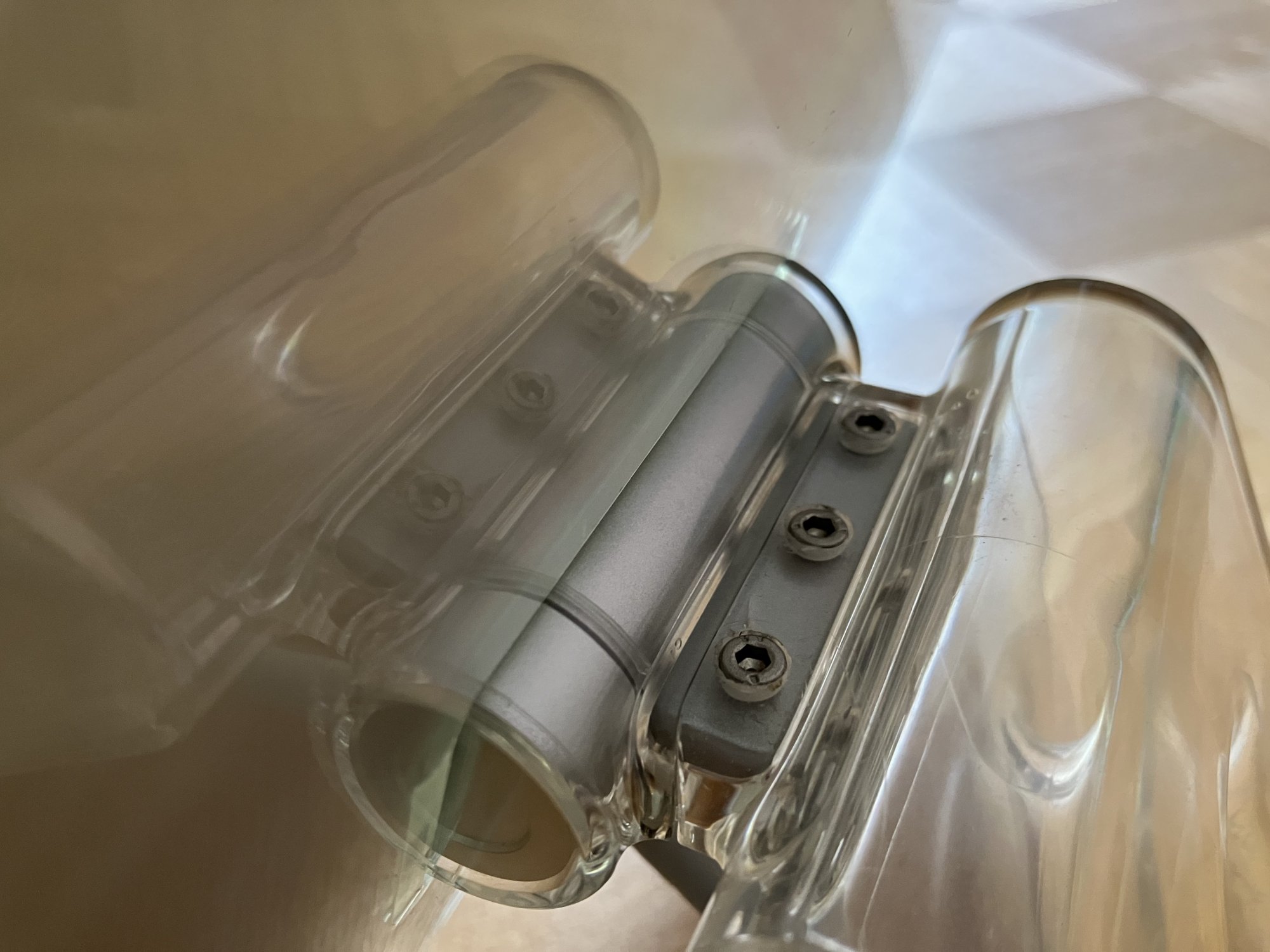

I recently got two displays for my G4 Cube: One (rare?) 23-inch and one 20-inch Acryl/ADC Display, both in mint condition. I put the 23-inch display on my desk and just tried tilting it, just to hear some cracking plastic. The plastic from the displays' stand cracked but didn't brake. The solution Apple used in these displays to connect the stand to the display is really bad: the stand is only fixed on the upper but the lower end of it is not connected to the spring although it could be. That makes the stand extremely fragile.

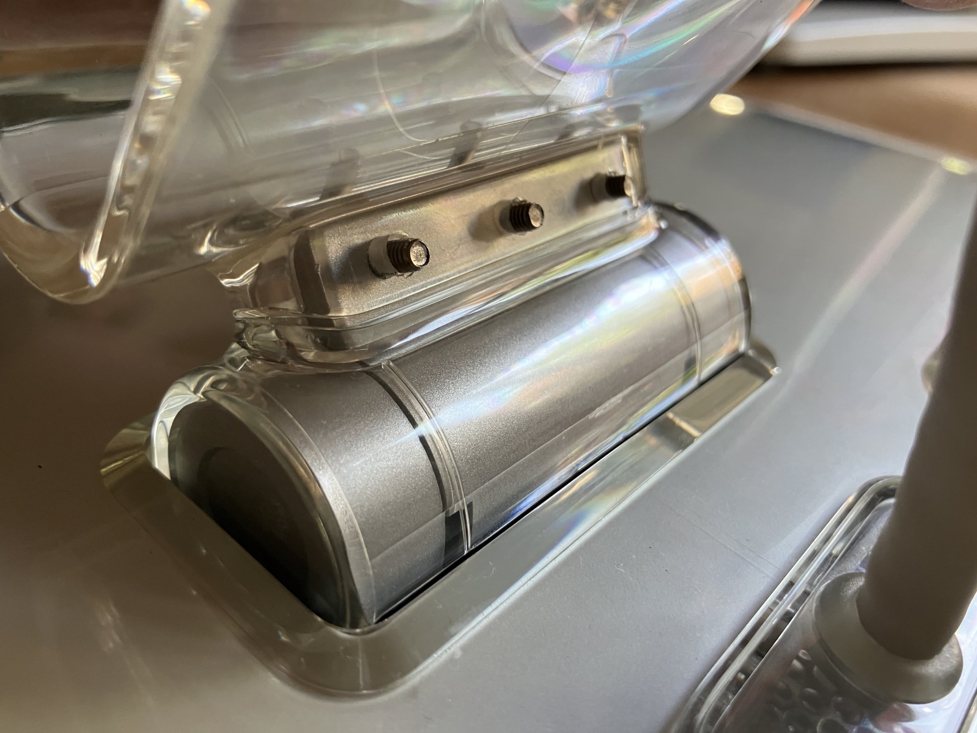

With the 2mm allen key, remove the three screws fixing the stand to the display. Remove the stand.

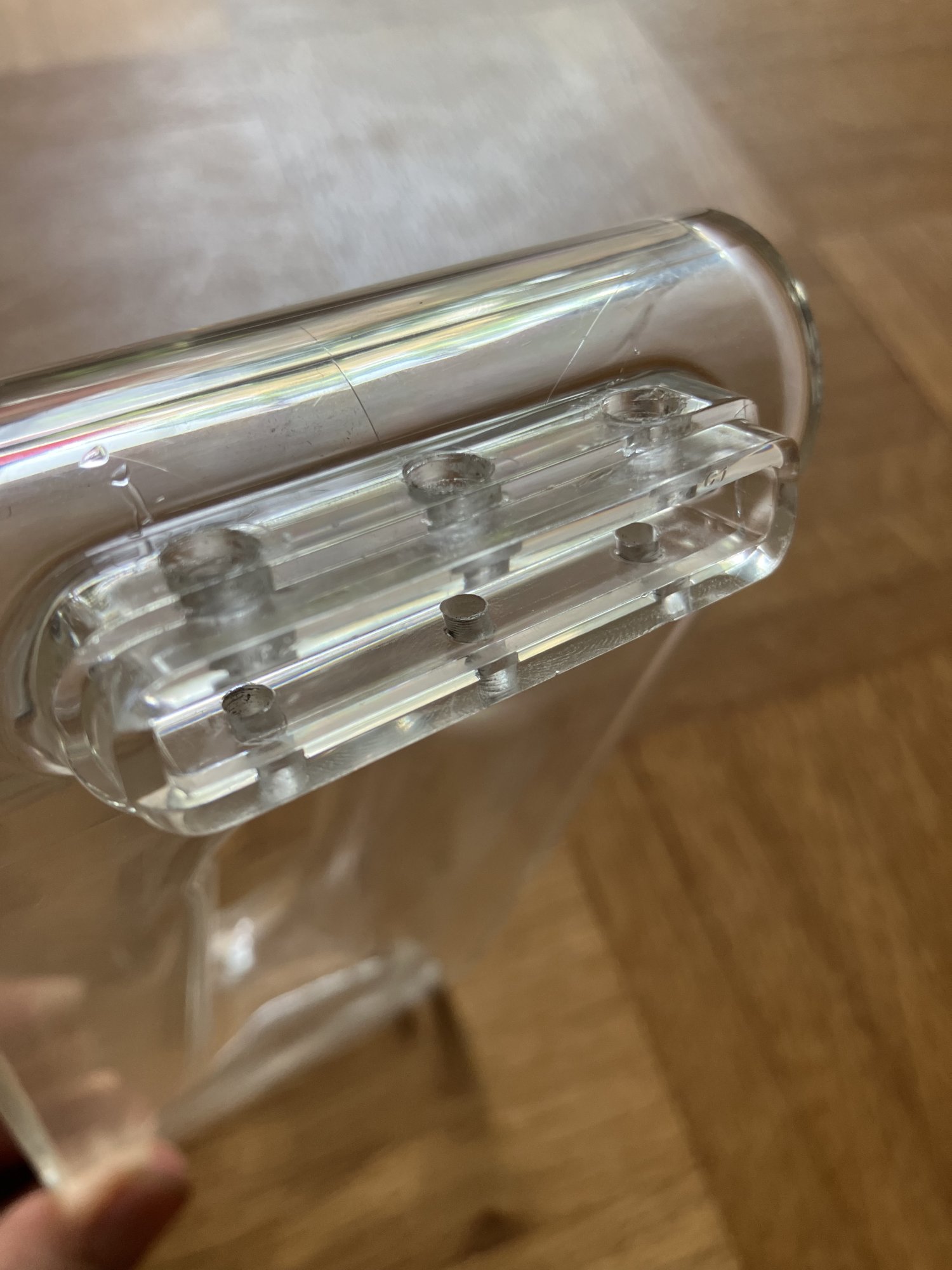

Then use the 3mm/3.3mm drill to drill three holes in the stand correspnding to the existing ones like this:

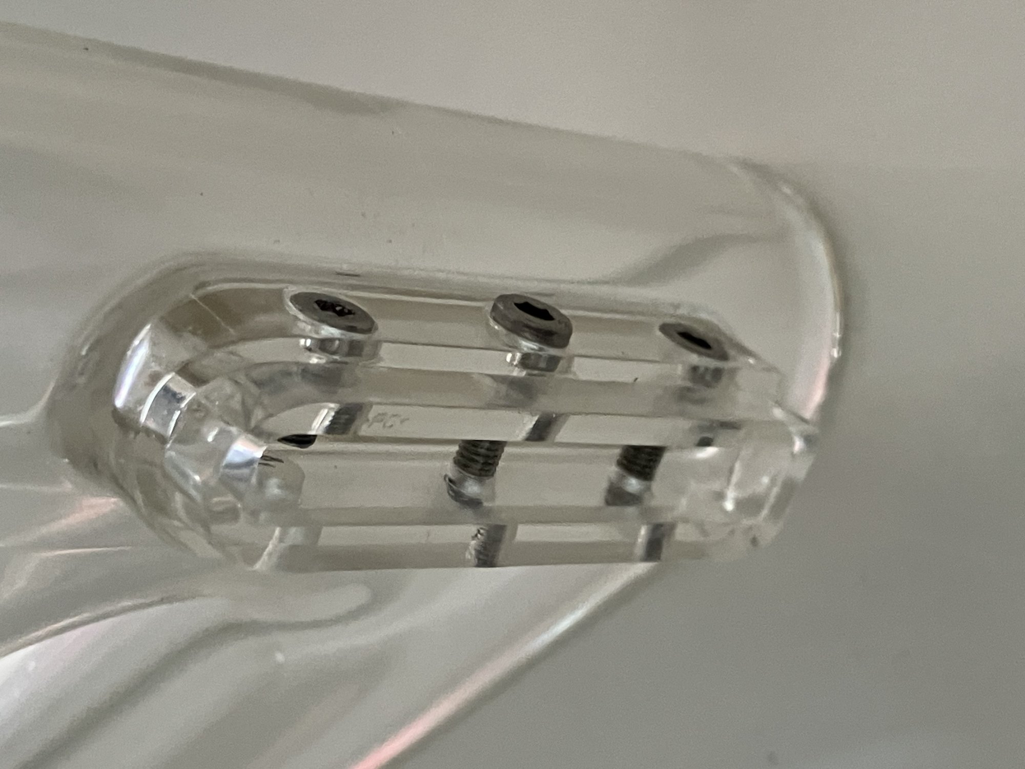

When the drilling is done, reassemble everything with the replacement screws. Now, the stand is fixed from the upper and lower side and is about three times as stable as before!

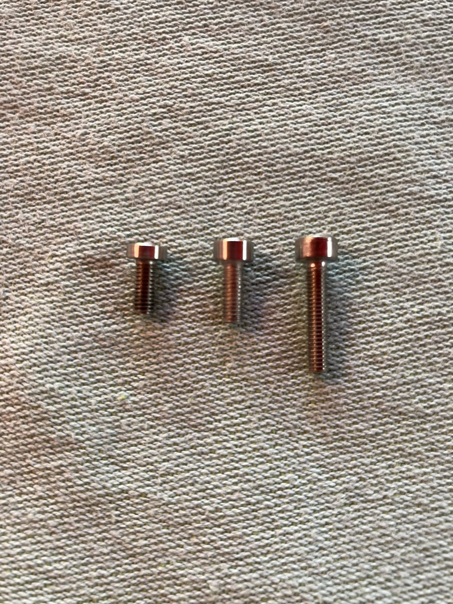

The left screw is from the 20-inch display, the middle one from the 23-inch and the right is one of the replacement screws:

Here are all recesses processed:

When that's done, reassemble everything with the replacement screws. Now, the stand is fixed from the upper and lower side and is about three times as stable as before!
