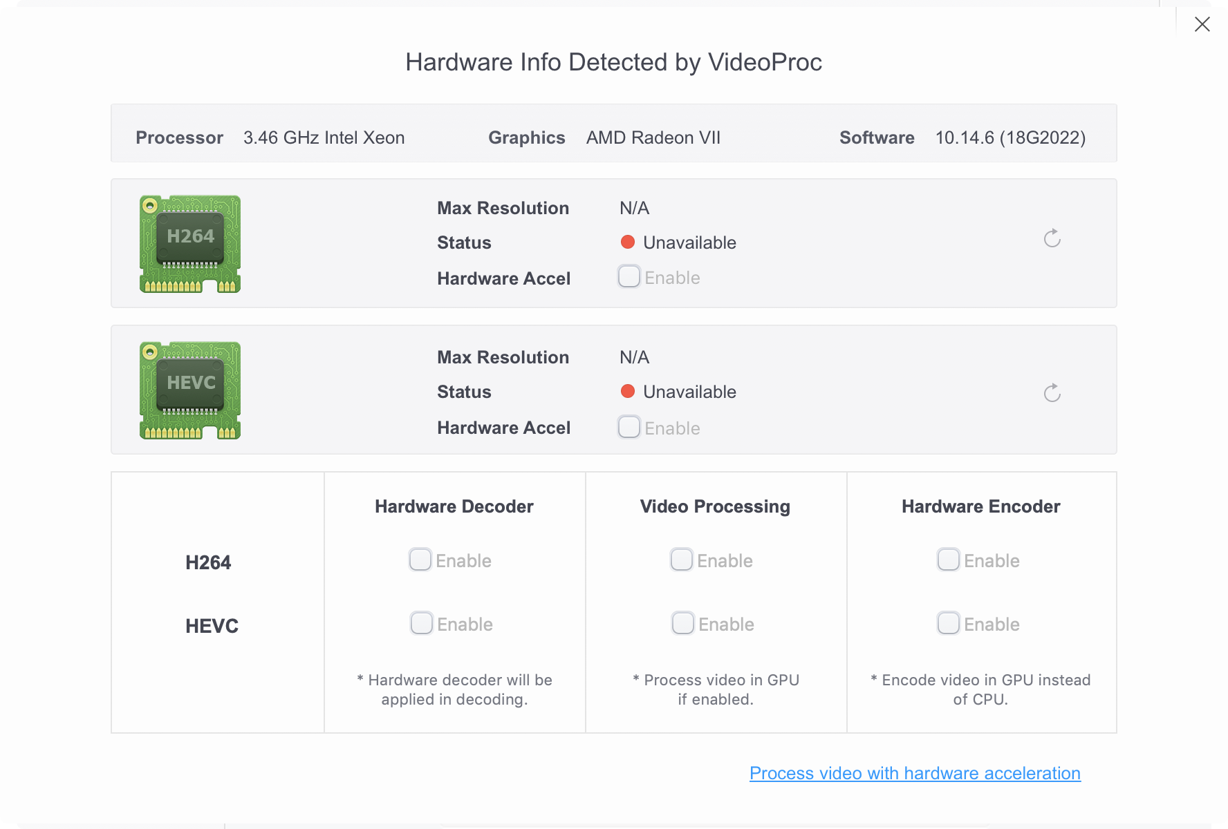

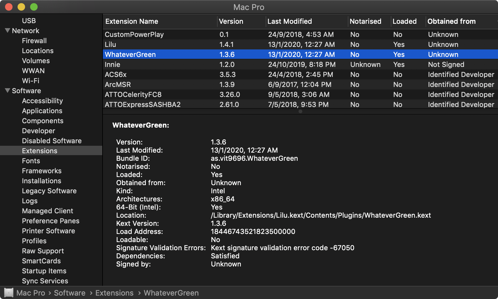

1) Latest self build WEG 1.3.6 and Lilu 1.4.1
2) Boot argument
Code:
sudo nvram boot-args="-wegtree shikigva=208 -radcodec"
3) No OpenCore or SMBIOS spoofing.
4) 10.14.6, kext loaded
5) Outcome, nothing works

Any feedback regarding what others did to make this work? FYI I’m running dual X5690 CPUs, 96GB Ram, NVME PCIE ssd, and Vega 56 (Pixlas Mod).
