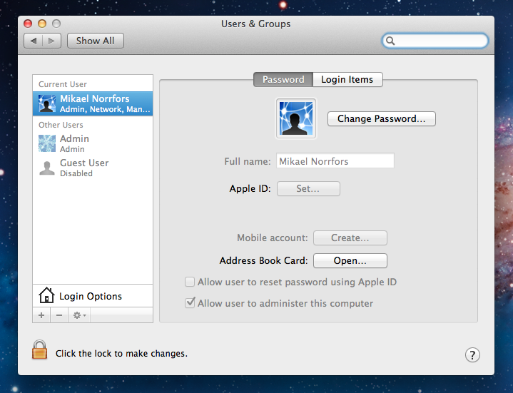

Uh, where am i supposed to see the Mobile Account? I don't find that option :-O
Found this screen cap on the google.
Strange, i don't got that option. The AD user is a user with Administrator rights, is there anything else i need to setup for the AD user? :-O
Here is a screenshot.

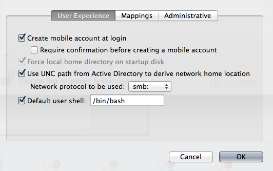

Open up the Directory Utility, unbind and change the options to where you have to add a mobile account.
