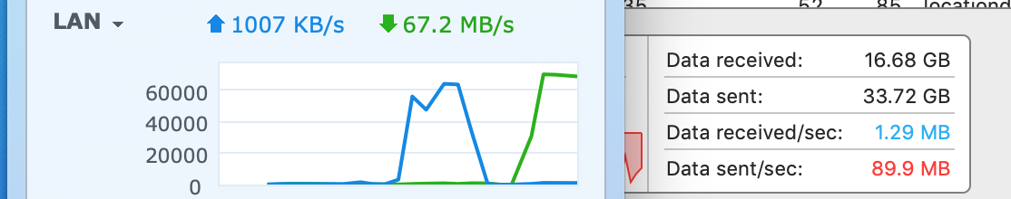

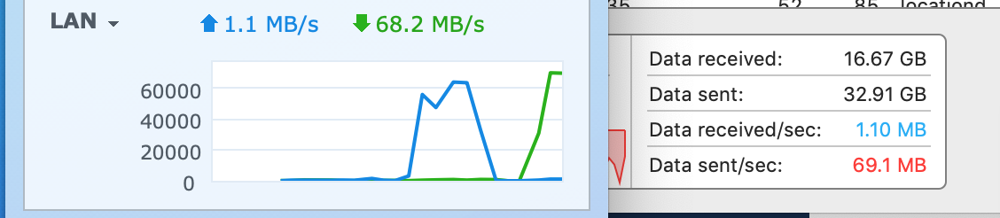

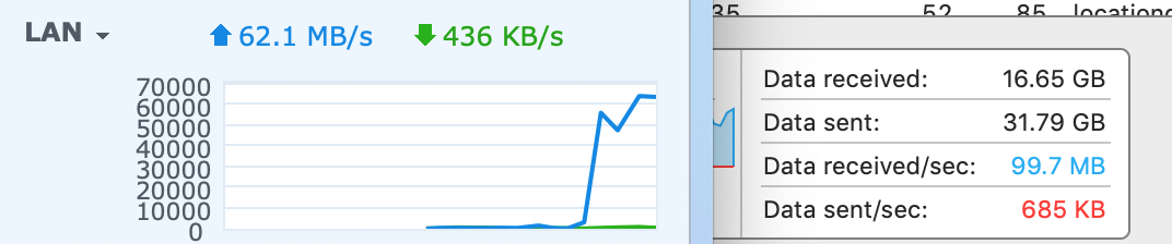

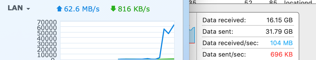

But in terms of actual time, the 2GB file was moved over from the NAS to the local drive in 32 seconds, so that's just over 500Mb/s, or 63MB/s. Moving the other way was 29 seconds, so 70MB/s.
Some comparison images showing throughput in each direction.
