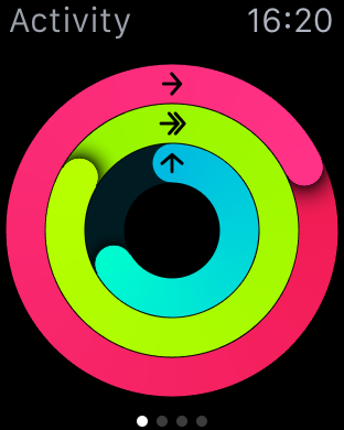

So two days in a row the exercise circle was slowly going up as I did very little exercise, like cleaning the house. I got full circles on those days from doing lawn work. So I have gotten complete circles.
The next day, I noticed it wasn't going up. I took a long walk, and it didn't go up. I then did an indoor cycle workout with a 140BPM heart rate, for 30 minutes, and it didn't go up.
Health recorded everything properly.
Has to be a bug. 😕

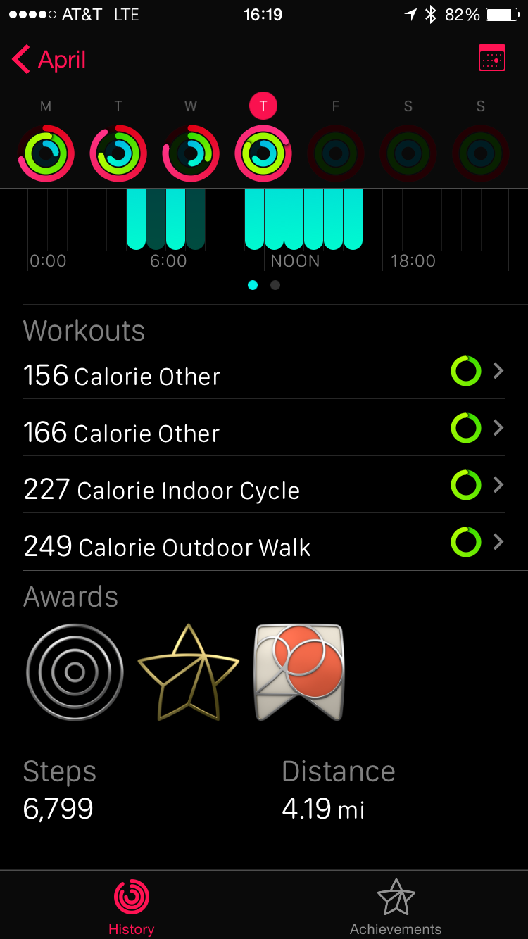

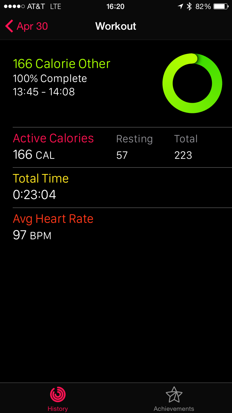

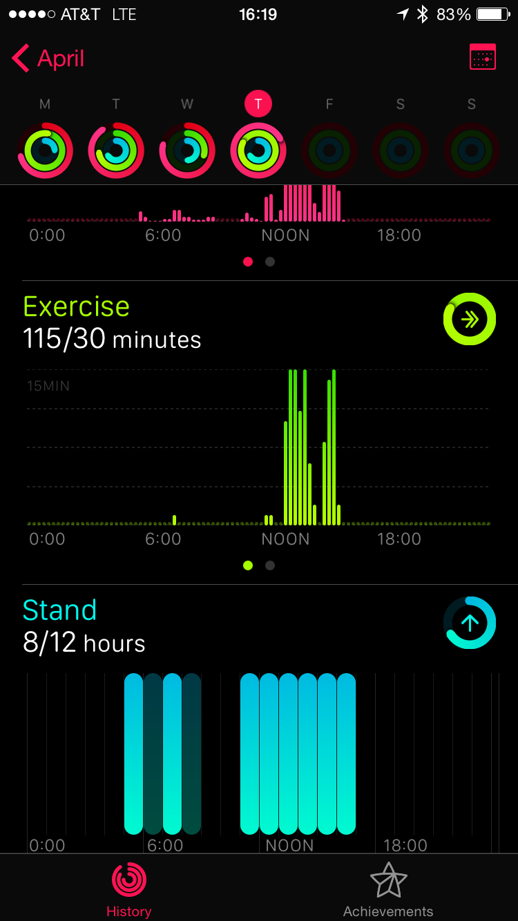

So, here is todays crazy update and test

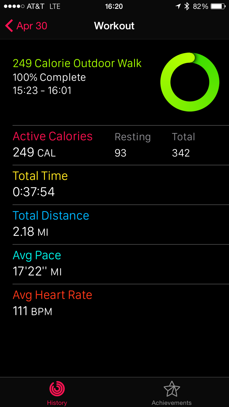

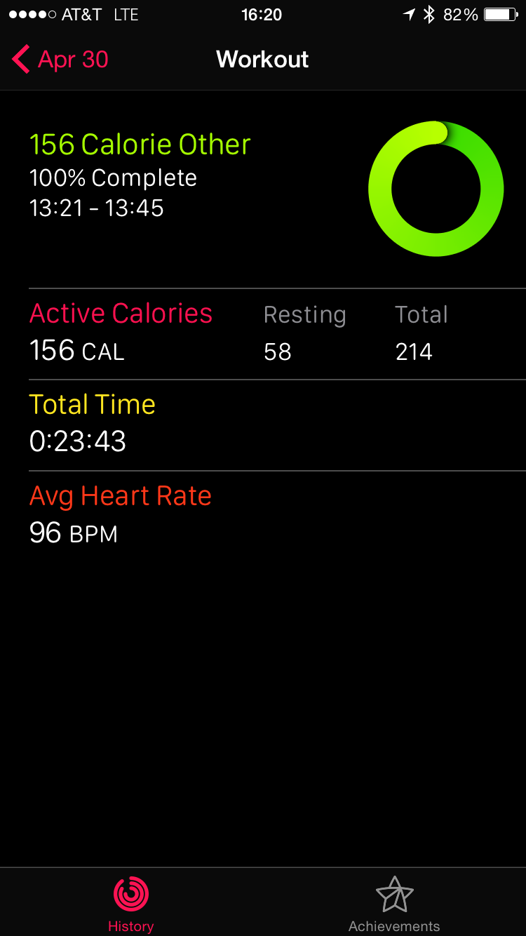

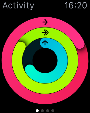

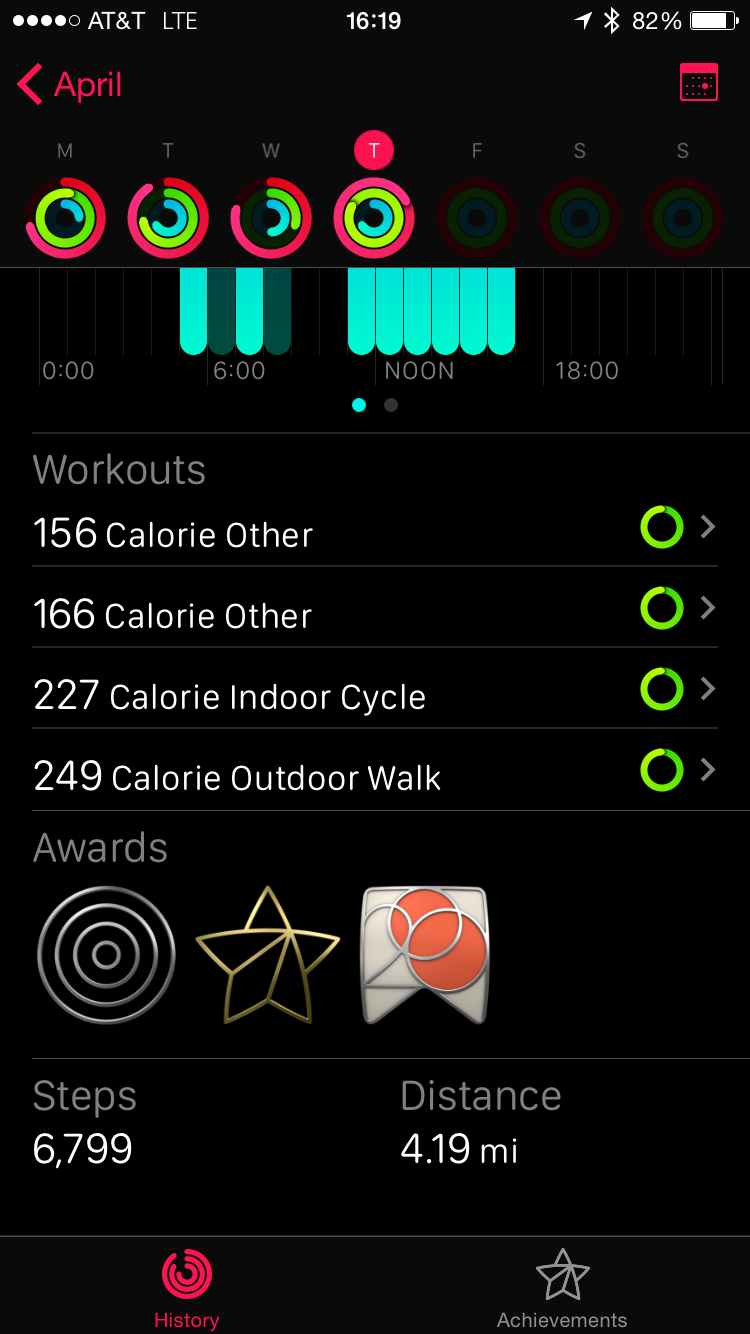

I started pre-workout with NINE 9 minutes of 30, must have been just walking around the house, work, etc..

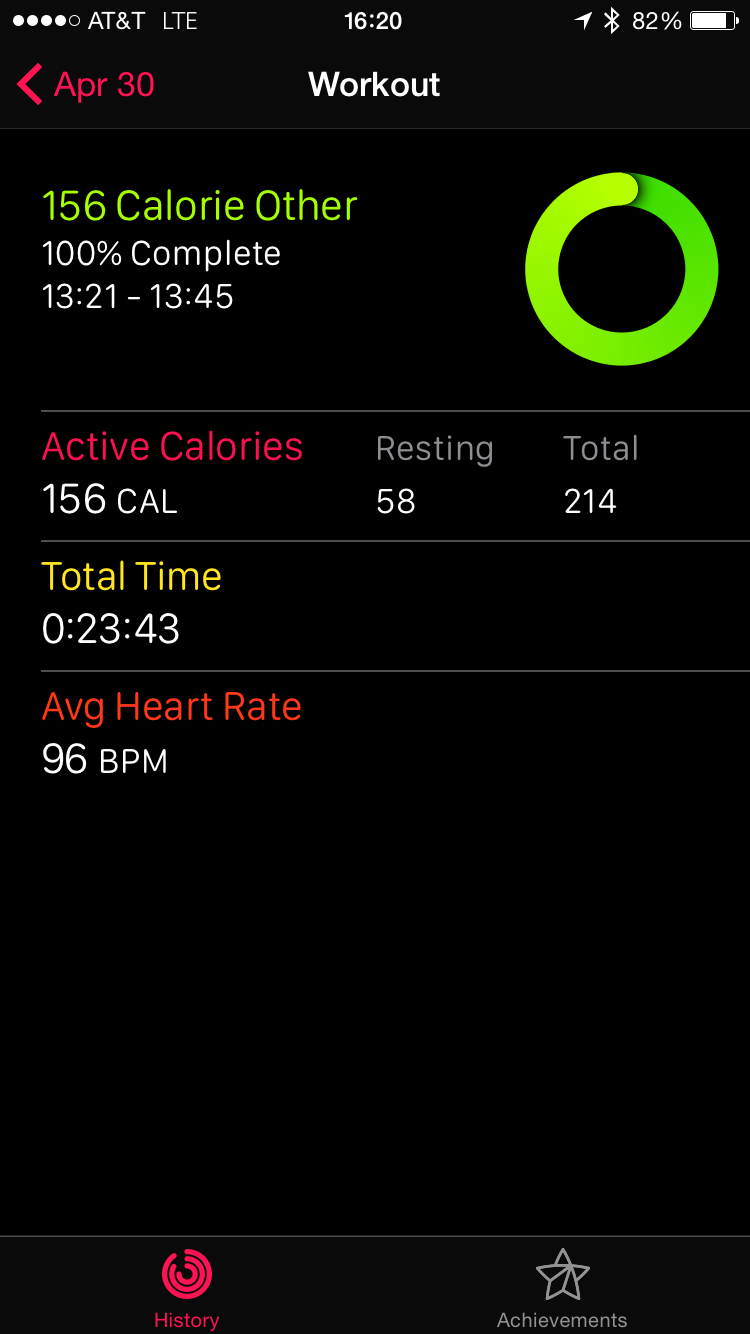

Then I did my first workout - weights tagged it as OTHER, 23 minutes (I actually hit the X button by accident, so I had to do another on top of it)
Then I did another workout - weights tagged it as OTHER, 23 minutes again

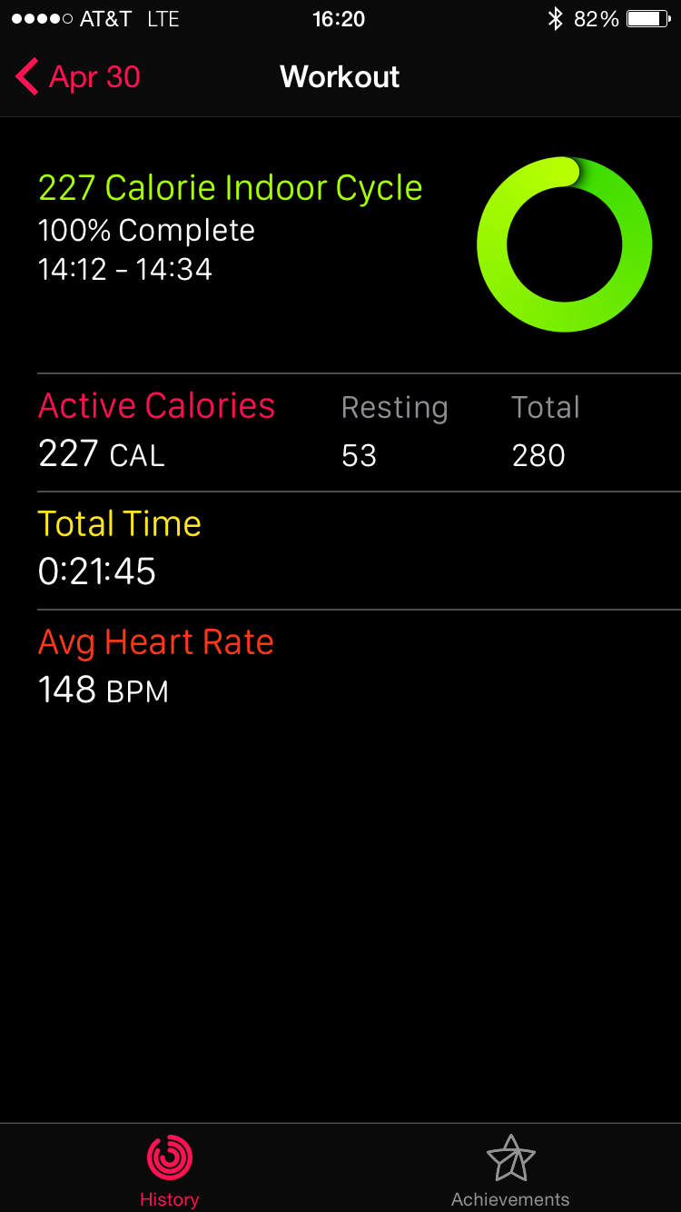

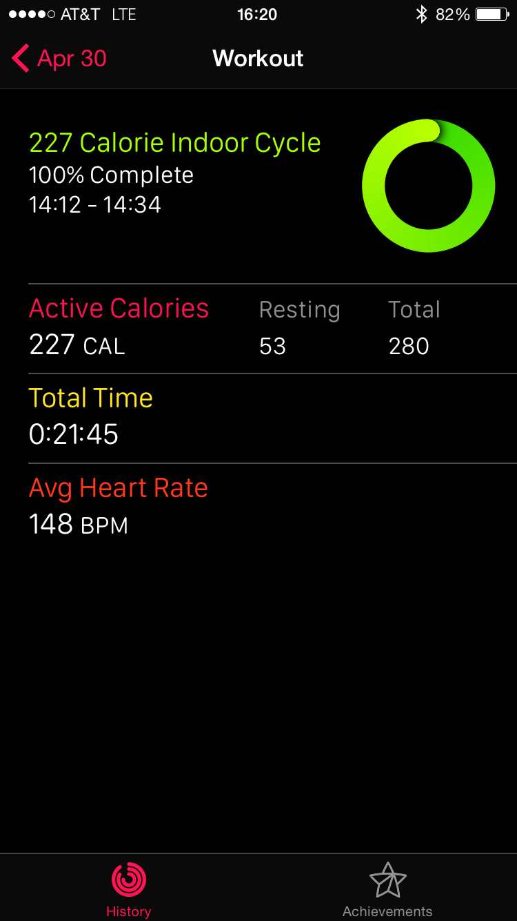

Then I did 21.5 minutes on the stationary bike (tagged as INDOOR CYCLING), trying to get heart rate up, even though many times while doing weights and squats it was banging at 165, 170

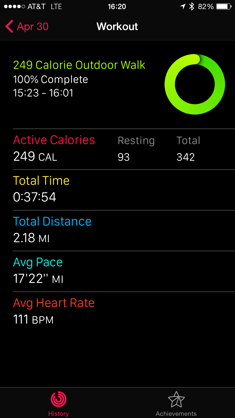

Then when I got home, I did another OUTDOOR WALK for 38 minutes, same walk as prior day, nearly the same pace
So, what is the total on the activity tracker for the day? 115, I recorded 115 CLOSER ENOUGH FOR HORSE RACING.
So, it DID add the OUTDOOR WALK as activity time THIS DAY, but not YESTERDAY.
Makes no sense, must be a bug.
more pictures
more pictures, by the way I got THREE REWARDS..

the issue that originally started this thread is that the workout data is not updating the activity app on the WATCH
continues to baffle me
Well, it continues to baffle me..
just when it seemed to work, today it's back to making NO sense.

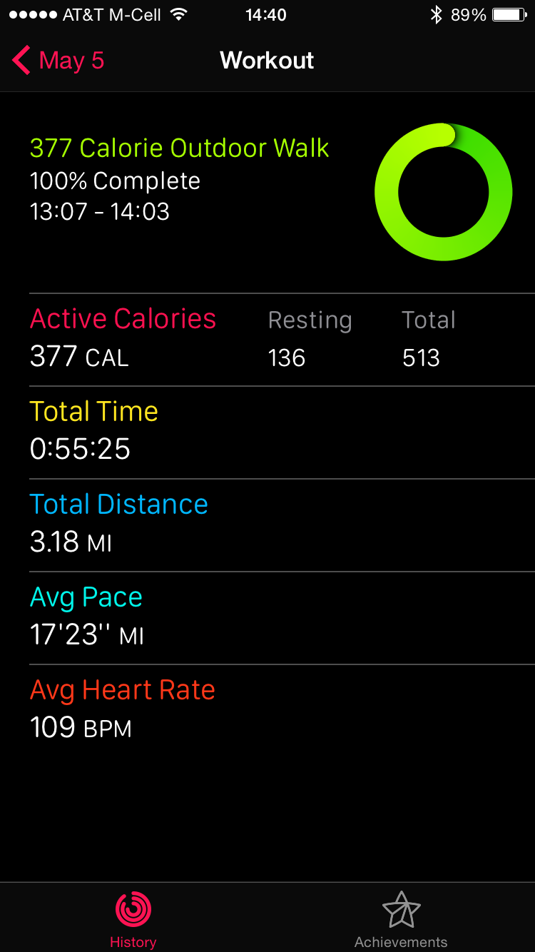

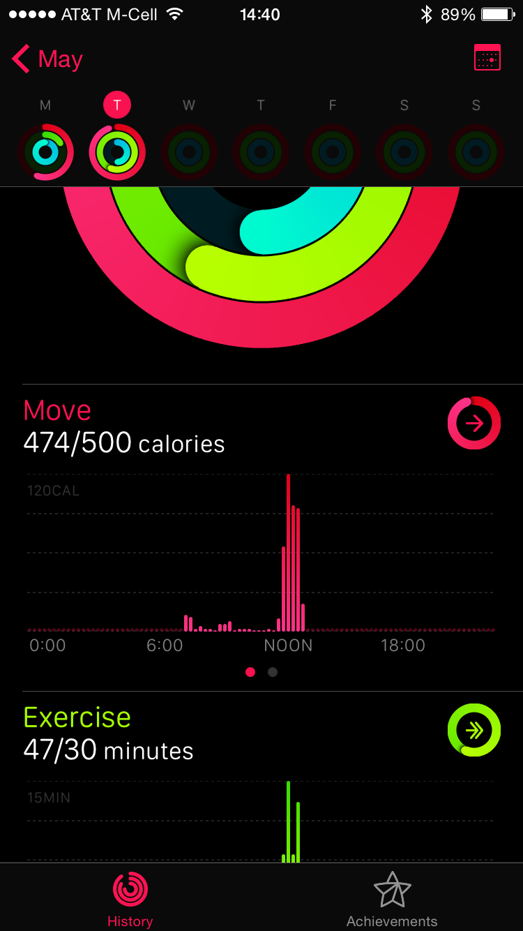

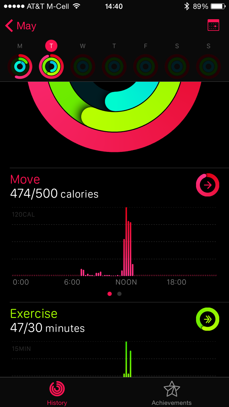

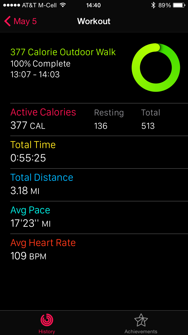

I started a walk with 7 minutes of 30 activity. I did a walk for 55 minutes, tracked it as outdoor walk, got heartrate up over 100 most of the walk, sometimes 110-120, and walked for 55 minutes.
Now, the activity tracker says I have done today 47 or 30 minutes.
NOT 55 minutes, and NOT the 62 that I would expect.. Actually more like the 55 for the walk MINUS the 7 I started with?
