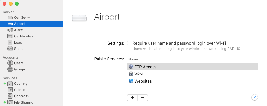

It can set the aspects of AirPort, related to services you run on your server. Mostly the port forwarding, but also a Radius-auth on your WLAN.
Because my APX was already set up when I installed a Server app, I have no idea if it could also carry out full initial setup of APX. But it is not hard to imagine having Apple built the AP Utility's functionality into their Server app, right?
OS X Server and AirPort Utility work in conjunction with each other. AirPort Utility is used for fine controls and initial configuration while OS X Server can add pre-determined settings in for various applications.
