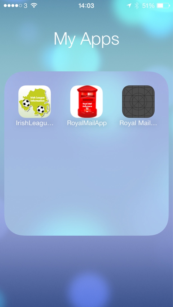

I have created an app that is used by a few work mates and myself, it isn't going to be submitted in the App Store, I have it uploaded onto my server and use the ad-hoc procedure to allow my friends to click on a web link which installs the app onto their devices but this procedure has problems under iOS 7 which i have reported to apple but i'm wondering if someone knows of a fix in the mean time?
When you click the link to install, the app installing icons appears and after a short time a second icon appears with the proper app icon but the install one does not disappear (see image below) even if i delete the app the installing icon stays. Any ideas on how to fix this would be much appreciated.
Try reinstalling your provision certificate.
I had this problem with Test Flight when messing with it a while back in iOS 6.
The problem I had seemed to be a mismatch between the provision certificate installed on the device and the one used to do the ad-hoc deployment.
Probably not a helpful answer

Purge all the existing profiles (relevant to this distro) from the device and try again. We had the same problem provisioning internal builds of our app to iOS7 devices (we actually use testFlight, but the underlying process is the same).
Cleared out the existing profiles (Settings >> General >> Profiles) and everything worked again, just perfect. I'm assuming the profiles that were migrated from iOS6 aren't compatible, so purging and reinstalling corrects this (allows iOS7 to sign/install them correctly).
I've deleted the app off my device leaving the blank icon still on screen because i can't remove it as no x there, I've deleted all profiles from my device then created a brand new ad-hoc profile and archived the app with this new profile and then uploaded it to my server and when downloading i still have 2 icons, my device has the proper icon which is a proper working app while the other icon is an installing icon?

We're experiencing the same problem too. I've done what you have suggested on my iPhone and removed the profile but it still has the icon there. I have had to 'Erase content and settings' on my iPhone many times to test out various different things to try and get this 'Installing...' icon to disappear. Doing the erase also removes the profiles.
Is there anything to do with provisioning certificates in XCode? Is it something that could have been missed off when rebuilding the app? The profile I'm using has a start date of Feb 2013 on it which would suggest that it's not created a new one for iOS 7.

I've had the same problem, for me the problem was that I used a different bundle-identifier in the app than I specified in the plist.
The solution was obviously to make them the same.

Me too: we've got this same problem. Tried deleting profiles on device, ensured signing with same distribution provisioning profile, checked bundle identifiers, and other suggestions on web. No luck. Filed bug report #15473961.
Found crude, manual workaround to remove the "dead" installation icon: restart the download and, once it begins, quickly delete the icon. That is to say that it seems to be deletable when it is downloading but dies after installation.
We fixed this!!! The plist file was referring the the wrong thing! It had been updated with a new app name and that hadn't been sorted in the plist file!
