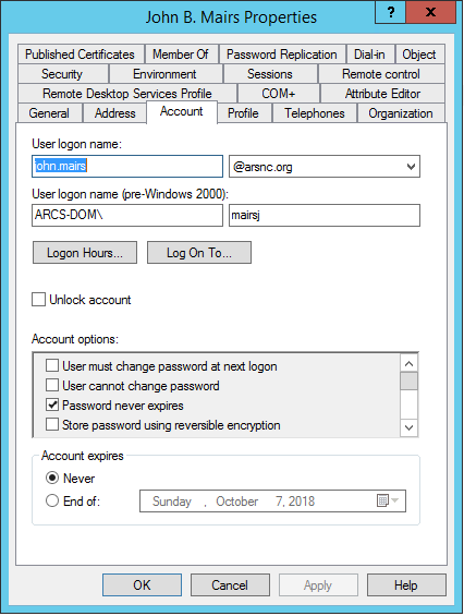

Also me, haha! Anything easy I can do in Windows Server to fix that? We're on Server 2012 R2. This probably happened when I set AD up to sync with Azure for Office 365 logins. Our AD domain doesn't match our email domain, so I had to add an additional domain in AD. Otherwise they would've had to login to 365 with this big weird username.

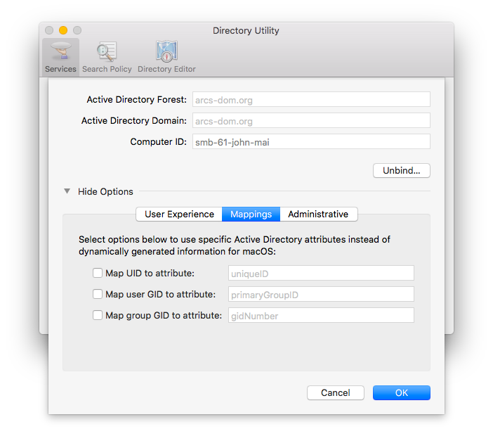

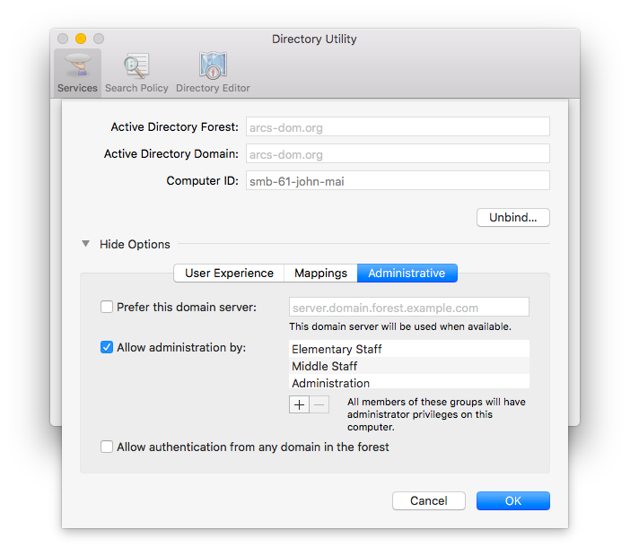

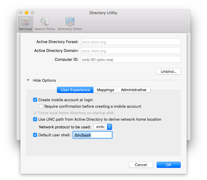

It most likely is related to your binding settings on the Mac, not the server. On my systems, in Directory utility I have only the following options checked:
Create mobile account at login (This automatically turns on "Force local home directory on startup disk"
Default user shell /bin/bash
Under Mappings and Administrative, I have nothing enabled.
What settings do you have?
I just added a screenshot of my AD user account tab to the post above. And attached to this one are shots of my settings in Directory Utility.
Thanks! 🙂

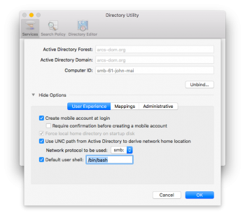

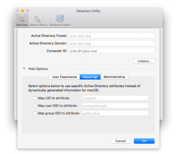

Thanks! 🙂
I would assume it's "Use UNC path..." that's doing it.
