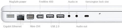

Hi there,
i have a Macbook that does not have an hdmi port but rather a couple of usb ports and something I have no idea what it is for but my question for today is.....

If my assumption is correct, that your laptop is the aluminum unibody MacBook, then it has a Mini DisplayPort. There are adapters for mDP->hdmi. That is what you'll need (assuming your tv does hdmi)

Your miniDVI does not support sound (assuming it's the alu macbook), so you will only get video from that connection.

Do keep in mind that you can go mini-DVI to HDMI but it will not carry sound. Just video. So if you're plugging it into a TV you will need another way to get the sound. Either with external speakers going to the headphone jack, or by using a PC-in on the TV if it has one. It's usually VGA or DVI along with a 3.5mm audio in jack.

You will need an adapter to get video to the TV. Check your TV and see if it has a PC-in of some sort. Usually VGA as pictured. Then you need to get the right adapter for your MacBook. Do you know what model it is? 2006-Early 2008 will use Mini-DVI, Late 2008 and Late 2009 and up will use Mini DisplayPort. The Early and Mid 2009 plastic models will have Mini-DVI like the original.
Mini DVI:
Mini DisplayPort:
If it's the MacBook in your signature, you will need Mini DisplayPort to VGA
And a 3.5mm audio cable to get it to the speakers if you have the input.
It's pretty much dependent on your TV at this point. I used my Late 2008 on my TV a good bit going through VGA and the headphone jack. Worked just fine.
