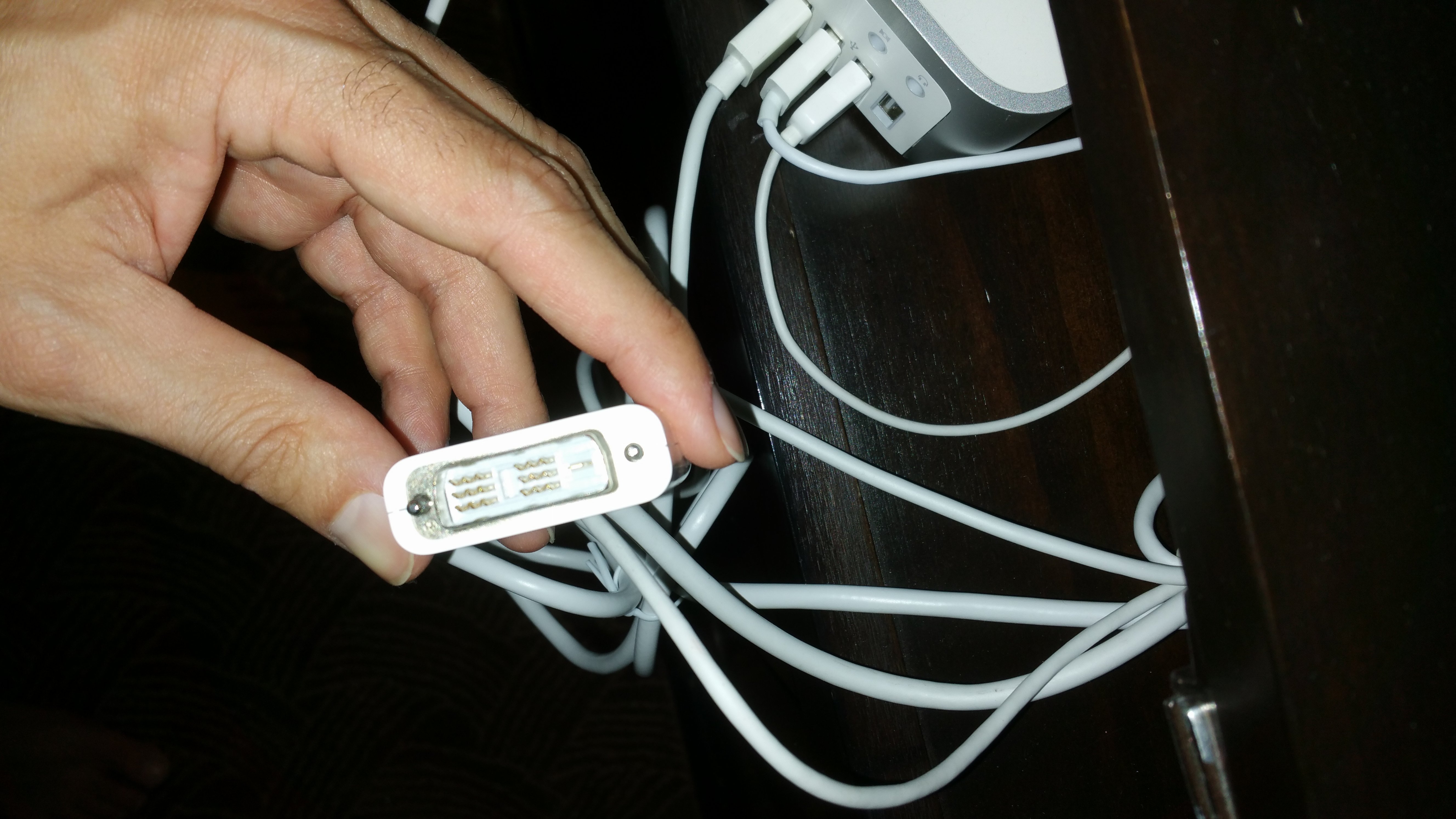

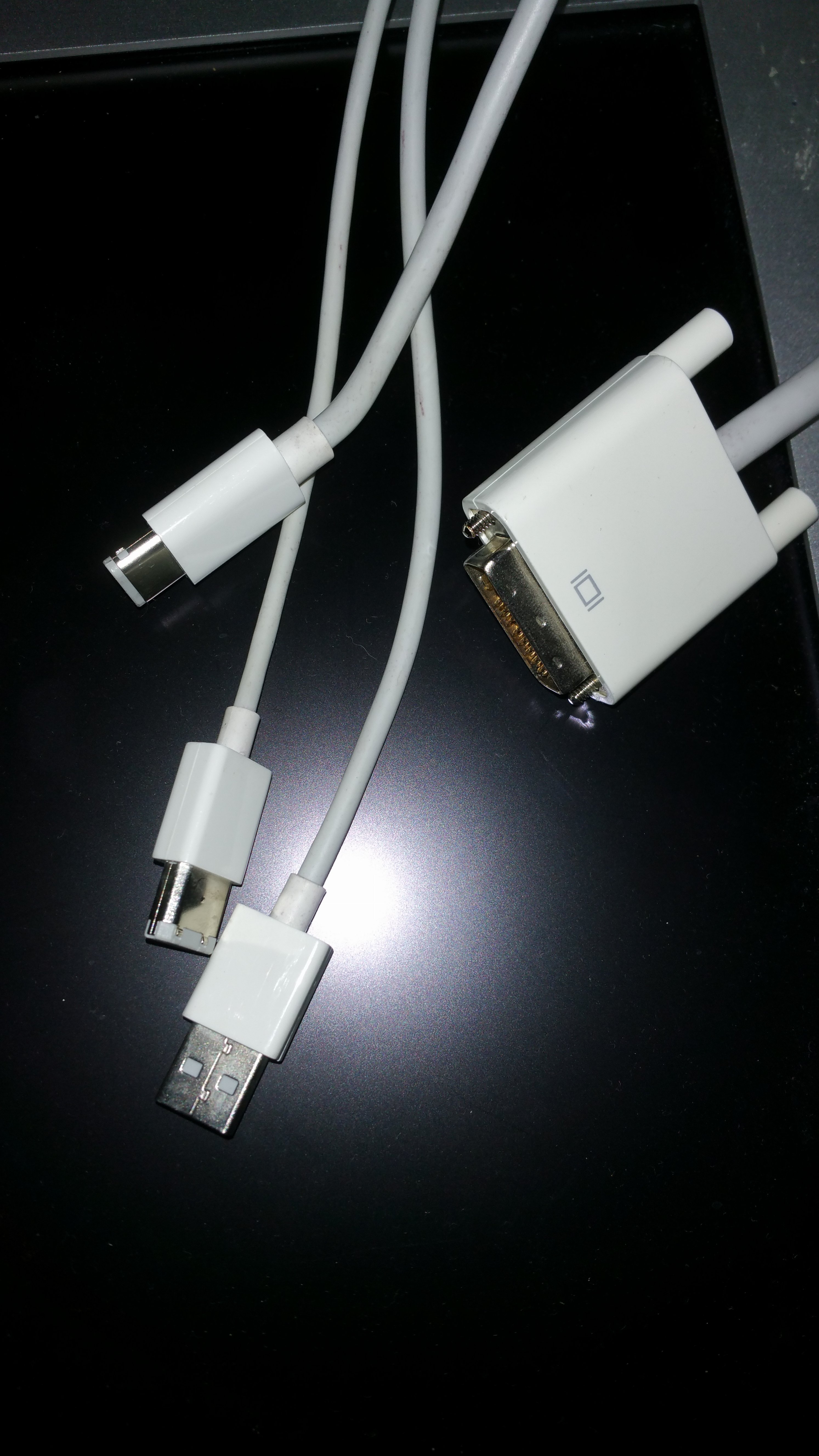

Here are photos of the connections on the back of the 30-inch and 23-inch displays. I have no idea what these area.
Thanks.
This is a DVI-D cable so that Mini Display Port to DVI adaptor should work just fine for that. $29 Direct from Apple but you could probably find it cheaper on Amazon.
