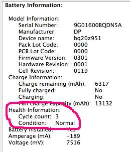

Thank you Fabian.
So in the "about this mac" where it shows total charge cycles, OS X is reading the battery which independently stores this information?
Thank you Fabian.
I believe so. Because if you swap to a new battery the cycle count changes. And I think if you move your battery to another Mac the cycle count goes with it. So the cycle count must be stored in the battery chip not the Mac.
