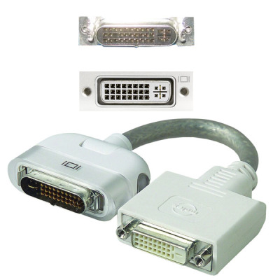

Hi I recently acquired a G5 powermac which has a GeForce FX 5200 graphics card. I have 2 monitors with DVI inputs and wish to use them both with my G5, if possible. the FX 5200 has one DVI output, and one ADC (Apple Display Connector) output. So I purchased an ADC to DVI adapter cable, but it doesn't seem to work. the G5 detects that the second monitor is present, but there is no display. the monitor in question is a Dell 2407WFHPC and works fine when connected to the DVI output.

When you say cable do you mean an actual cable?
I ask, because our work G5 has a video card with DVI and ADC ports. We use this to convert the ADC to DVI (it came with the Mac).
yes! thats the exact cable/adapter I purchased

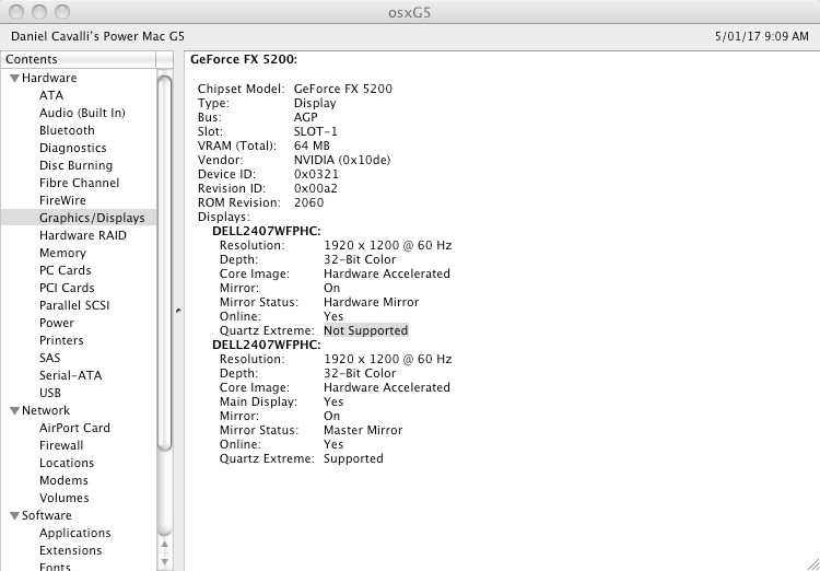

Hi eyoungren, firstly thanks for your help.. ok so I've reset the NVRAM and played around with different resolutions but no luck. according to
http://www.everymac.com/systems/apple/powermac_g5/specs/powermac_g5_2.0_dp_2.html
my graphics card should support 2 displays at 1920x1200 anyway. here is my graphics display profile:
so both monitors are detected, the only difference I can see is that "quartz extreme" is not supported on the second monitor. not sure if this is relevant to the problem or not.
