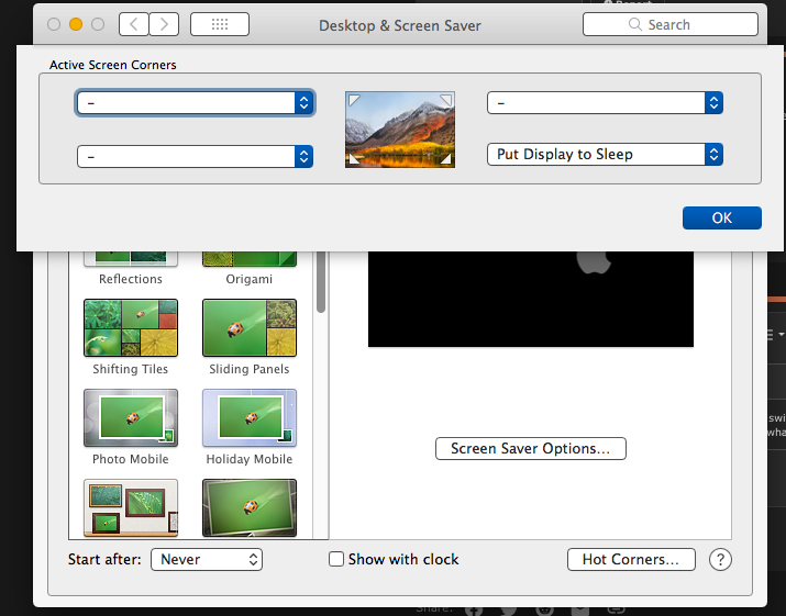

Don’t overthink this! You already have a “switch” of sorts.
Using High Sierra on my 2013 iMac as an example here, open the Desktop & Screen Saver prefPane (or similar, for whichever macOS iteration you’re running). Next, select the “Hot Corners…” button. Then, pick a corner (or corners) you want to use when you want to shut off your display without shutting off the system. Then, move your pointer to that corner and put your backlight to sleep instantly.
I personally don’t use a screen saver at all, so when I’m done for the day, I send my pointer off to the bottom-right (or “south-east”, if using cardinal description) corner, and the display backlight shuts off until I move the pointer again.
This feature has, more or less, existed in some form, ever since the early days of Mac OS X and has carried through onto macOS.

@B S Magnet this seems pretty interesting, as long as:
-it can be done on Ventura
You should be able to.
-I can do that very fast right from the menu bar (adding a shortcut)
That’s sort of a cumbersome way to do it (versus just moving the pointer to a corner), but I’m sure a script can be made to do it.
-It only disables the backlight while every task is still running
Yes, moving the pointer to the corner, as I showed above, doesn’t affect anything else. The system continues to run with a pitch-black display. You can even be listening to music or compiling with the display off. To use the display again, move the pointer away from the corner.
There is one thing it won't do however, and that is keep the backlight disabled after reboot or during a macOS install, and most likely if I click the mouse it will restore backlight instantly.
At that point, what you’re describing is running your iMac in a headless mode. The feature I shared above is not related to running your system headless.
I'll be sure to try that on my iMac then. I got a screenless MacBook base to use when I want to run my system "headless".
I guess I misunderstood your comment, because if it's as easy as moving your mouse to a corner, I certainly don't want to add another shortcut to it! I read it again and noticed that's exactly what it said, but for some reason I thought you needed system preference open or whatever, I'm just stupid lol!
The only issue is I don't think screen saver disables your backlight entirely... and also I need to set it to a completely black screen!
Or again I could just be stupid as putting my display to sleep and screen saver are two different things...
