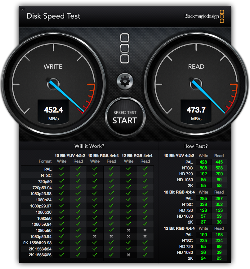

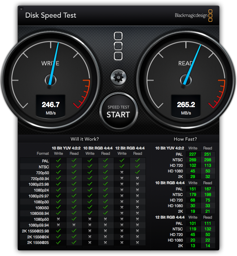

This is my plain vanilla 840 in Bay #1:
Here's an 840 EVO on the Velocityx2:
I used CCC for the EVO, moving OSX off the old 840.
I am using the 840 for Bootcamp/Win7 now.
