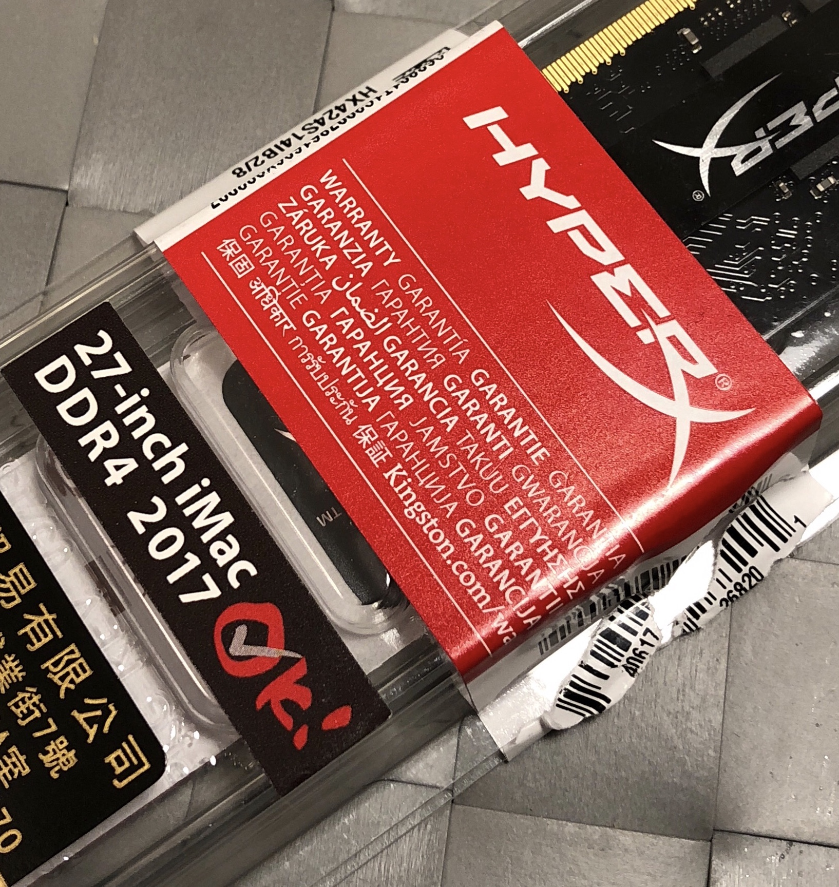

Asking for the same money (with a true 2400MHz RAM) for an overclocked RAM which doesn’t play well with other 2400MHz RAMs, with no indication anywhere on the package saying so (the overclocking), is borderline deceptive in my view.
The distributor even added a sticker for “compatibility with iMac 2017 27 inch” on it.
And may in fact void Apple's warranty if something should go wrong with that memory installed. Best to avoid overclocked modules and stick with compatible memory. For those folks who have that memory installed probably know the risks when overclocking memory or the bus.
I'm not sure that it is the responsibility of Kingston in this case to ensure that its RAM will work together with RAM from other makers.
It is compatible with the 2017 iMac. There are users in these forums happily using it. What it doesn't do is mix well with standard CL17 RAM.
As others have alluded to, it is compatible.
However, you paired it up with another manufacturer's product. On a good day, this is a poor idea; and now you have experience on why it is not a good idea to mix brand names of memory.
This scenario sits squarely on the person selecting and installing the memory, no one else.
