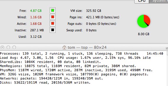

Activity Monitor is not the proper tool for measuring paging activity.
Use 'top' in the Terminal.
Why would you say that? Activity monitor shows the page ins and outs in units of bytes. On the other hand, top (ironically, at the bottom of the screenshot) gives the same values but in units of 4KB pages. Same information but not consumer friendly.
It's not the same information. Activity monitor gives only cumulative values. You can watch instant values in 'top'.
top shows the number of pages in the sampling period, not MB/s.
But it is the instant rate, and more accessible for most people.
I agree that the instant rate is theoretically more important, but who has the time to watch it all day and know when/what is causing page outs? Mostly when I look at instant rate it is zero.
If you restart the computer (reset page outs)...use it....and next day have a few Gb of page outs, then you need more RAM, though you may not know what app or usage was causing it.
