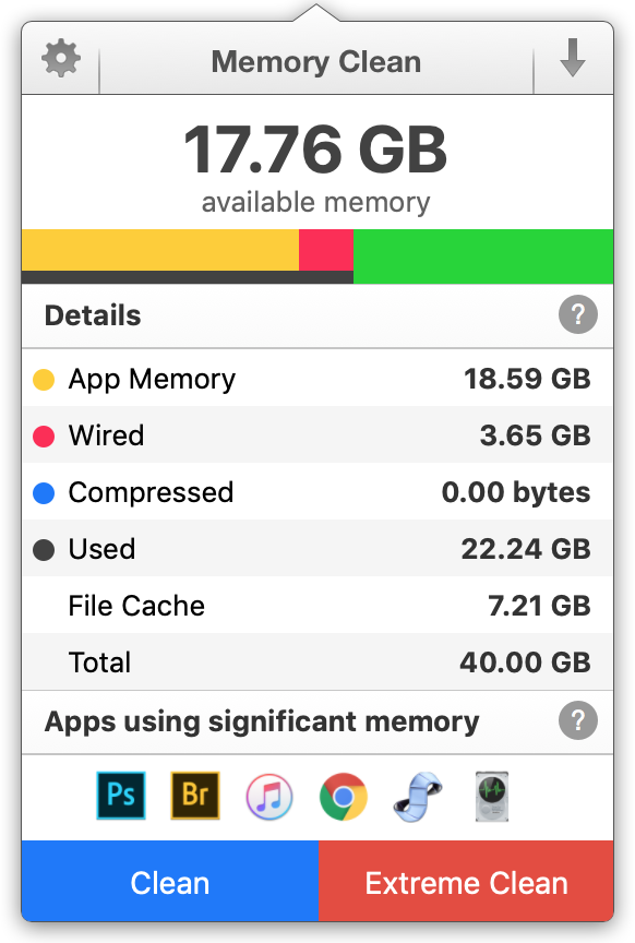

I don't think you'll get a Geekbench boost going from 16GB to 64GB. However, I do think you'll get a real life boost with any kind of paired RAM increases.
I'm not even doing anything and my machine is using a lot of RAM.
Look at the macOS’s own memory pressure charts. The OS “uses” a lot of otherwise spare memory for caching which is not necessarily “in use” as such, depending on whether a 3rd party stats app knows that it may mis-report it as in use. No way you’ll be using c. 20GB RAM whilst doing nothing.
