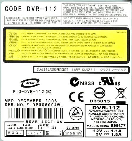

From what I've read, both drives need to be set to cable select, which is usually a jumper setting that is shown on the drive OR no jumpers at all. You dig?
edit: found this image... if this is the same as your drive sticker, it appears the cable select is the #3 jumper position.

I'm diggin', Sean. Thanks! Have just tried with jumper in Position 3, but not working. Will shut down and take it out altogether.

Maybe put it in by itself and determine if it's DOA or not.
Also, check the jumper setting on the Sony drive... perhaps they should both be set to cable select, or have the jumpers removed altogether. From what I have read, for the OSX and Mac Pro to run 2 drives properly, it needs to have the cable set up the chain.
So maybe no jumpers on either one will do the trick.
With two IDE drives I had both set to cable select, that's what worked for me. On my IDE drives (Sony drive that came with my Mac Pro and a NEC ND-2510A) cable select was position 1 (furthest away from the IDE and power connectors).
