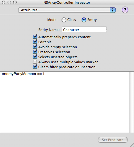

Alright, I see what you're saying, but I'm having a bit of trouble with the filterPredicate. What do I bind the predicate to? Here's what I'm trying right now, is this what you meant? 🙂
Not there, in the Attributes box: 😉.
