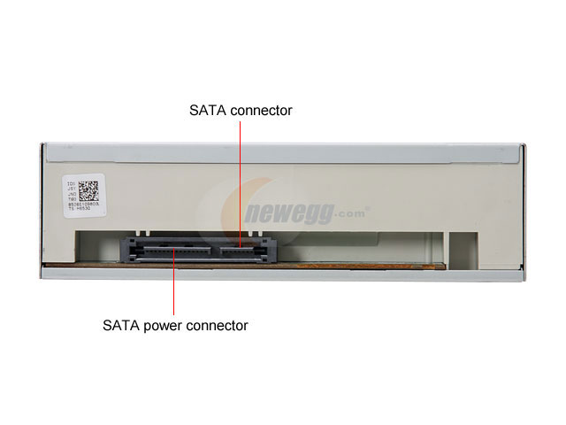

After reading about ATAPI interface standards I'm still confused about what the optical drive interface that is being used in the new Mac pro. I'd like to add a second drive but the Apple drive that came with the Mac Pro is so loud that I'd like to use a different manufacturer's unit.
Can someone (who has done it) please specify what unit will fit up to Apple's connector. Thank you
Have you looked at the connector? Doesn't look like SATA to me.

The optical drive that comes in the 2009 version of the Mac Pro is a SATA drive. From what I have read, Pioneer is usually the OEM of Apple's SuperDrives, but any brand SATA optical drive should work just fine.
Earlier versions or the Mac Pro used PATA optical drives (like the one pictured above) that are connected with an IDE connector (flat ribbon cable).

What confused me is that Apple joins the separate data and power connectors together (for convenience) making it look like a single connector at a glance.
